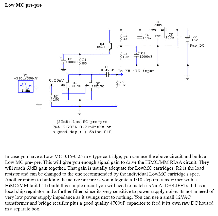

Looking for a MC pre (10db) pcb that doesn't do the subsequent RIAA eq.
Joined 2003
I have a preamp that has a nice phono stage, but is only for MM cartridges. I'd like to build a mc step-up unit that I can fit inside the preamp, there is space but it would be tight. Transformer or active is fine.
Almost all the designs I can find do the eq as well. I know haglabs used to sell the Piccolo, but no longer do. Kankd has a lundahl xformer kit, but looking for options to compare.
Not a pcb, but easy enough to do on perfboard.
https://www.diyaudio.com/community/threads/2sk170-bl-mc-step-up-amp.188730/post-2567139
