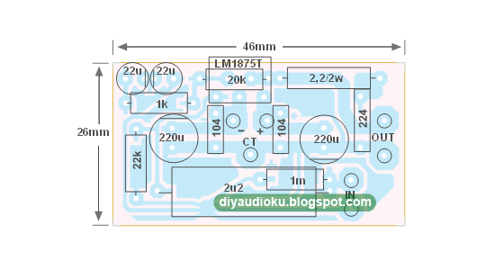

Can you give a picture of your lm1875 system?
I'll try if I could get a picture of it later. It is sealed in the box.
I used this
It is a single LM1875. I need something a bit more powerful than that since I'll be creating a whole new system with new loudspeaker and stuff. I won't touch the LM1875. It is a pretty rock solid build for my PC.
