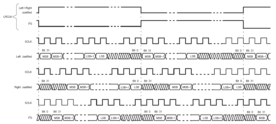

Most of the time, data is transferred in either left-justified or "true" I2S format (which is just like left-justified with an extra 0 bit thrown in before the MSb, and LRCLK inverted). That means that the most significant bit is transferred first and so on, until the least significant. This is followed by enough zero bits to make 32 bits total per channel, or 64 bits per LRCLK/WCLK cycle.
You can create a 6 dB attentuation by shifting the data one bit right, or a delay of one BCLK/SCLK cycle, but there is a complication because you need to account for the sign bit. That is, you need to duplicate the sign bit (MSb) into the new MSb position, rather than just filling with zero or delaying the entire 64 bit stream by one cycle. That makes for some complicated logic, but it has been done. I recall that someone on this forum came up with a design using some 74xx logic chips a few years ago.
If 6 dB is too much, then there is no easy way to do it I am afraid. You will need to re-calculate all new samples attenuated by the desired amount. That means DSP. You can get by with something easy (easier?) to use like the TI TAS3001, TAS3004, or TAS3103. You will need a microcontroller to configure the chip over I2C, but you don't need to write any DSP code, just program some configuration data into the thing.
I stole the attached depiction of the various serial data formats from the TI TAS3103 data sheet.

These are very interresting thoughts.
Unfortunately 6 dB will be a little to much for this purpose I think.
And to use a DSP for that only is overdoing for sure. If the DSP would be usable for additional functions o.k., but here...
I think I have to forget about the project. What a pitty. :sad:
