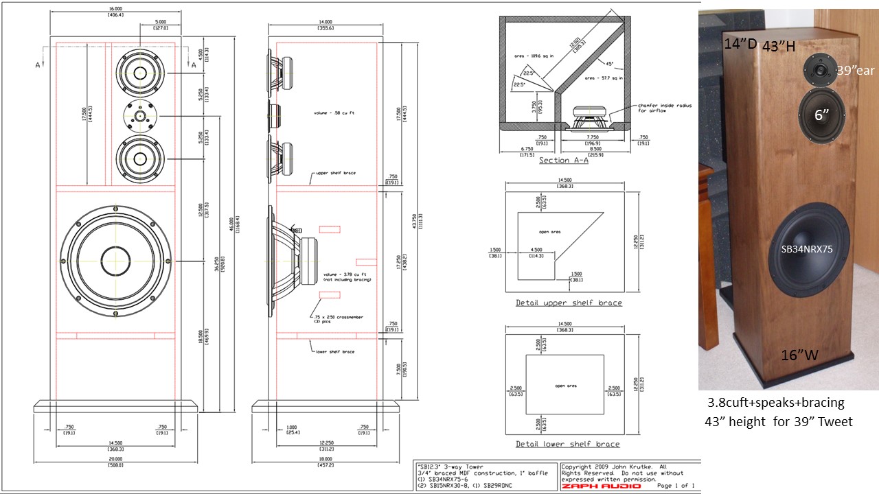

I have the same question of a friend of me to design such classical three way. I already have some ideas on paper how it will look like.
I will use the 11 inch Eton 11-212 in closed box, the 6.5 inch Accuton C173-6-096E and the Seas Be tweeter E0058. Crossover at 300 and 2000 Hz. I will make a digital filter with miniDSP for it.
If you are interested in, I can design a passive filter for it. For me it is always interesting to have some feedback of practical realizations of such designs.
In attachement the first drawings of the cabinet.
Paul

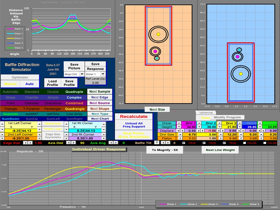

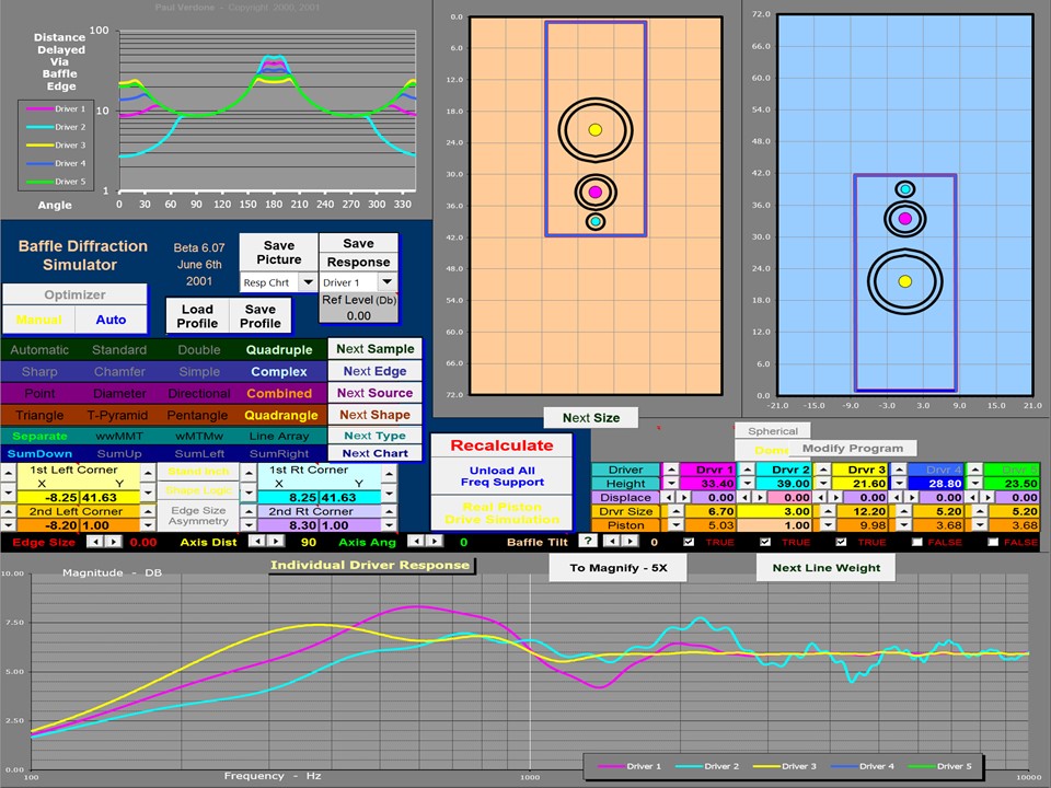

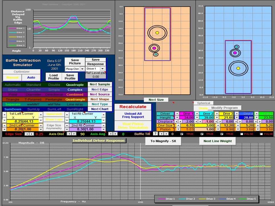

MiniDSP cannot correct baffle edge diffraction effects and the room-wall sound reflections which are generated. Edge Bevels and Rounds. Tweeter off-center mounting. If cabinet construction extremes like the Avalon bevels or large radius quarter round edges do not fit your style, modest radius edge rounds plus center offset of the midrange and tweeter are a decent diffraction solution. In Zaph's cabinet construction, note how driver offset allows a simple angled internal board to create a tapered rear volume behind the midrange which will reduce resonances.
Stephen and Paul, The attached baffle diffraction sims of (basic box) and (TM offset+1" bevels) might influence your cabinet build.

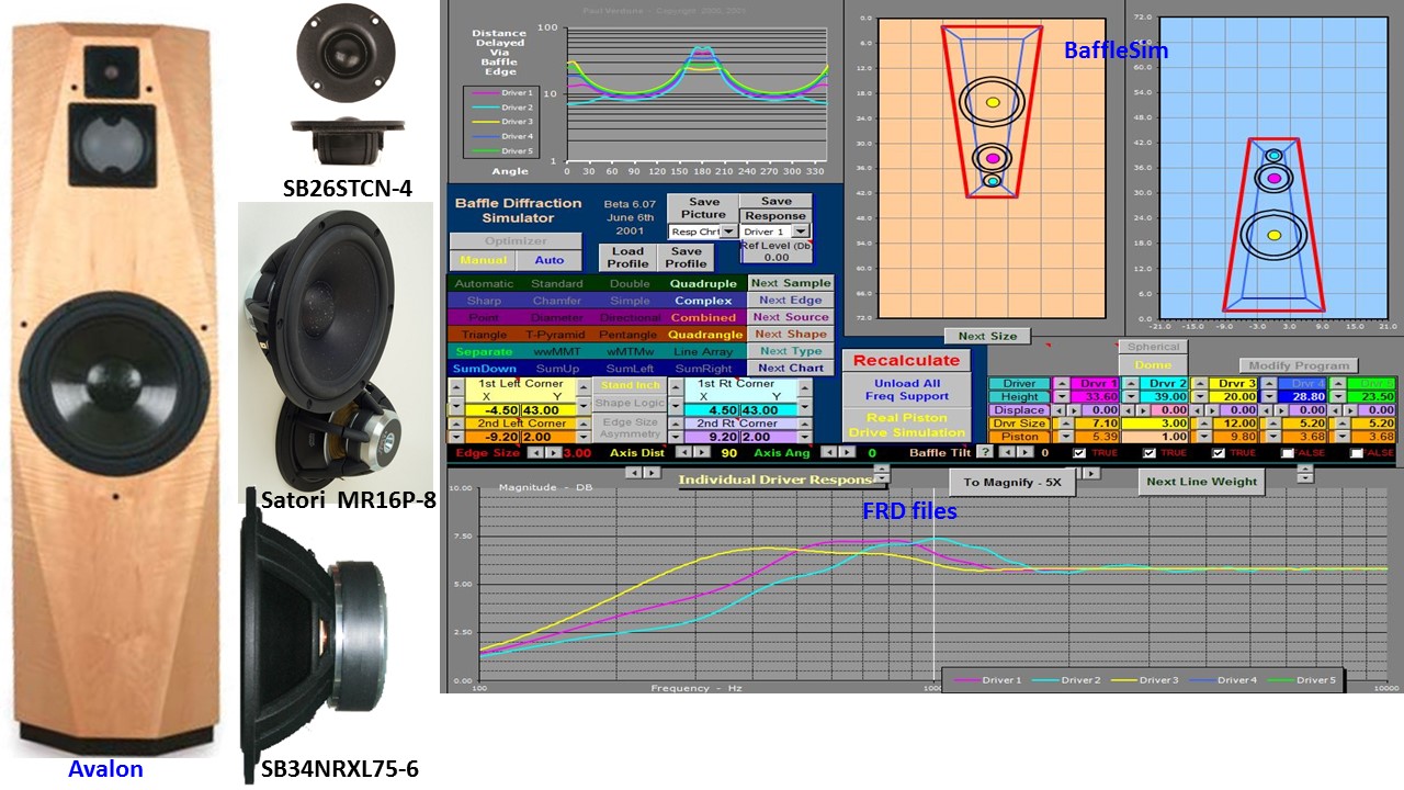

ported 12" example:
The SB_Acoustics 12" woofer SB34NRXL75-8 sims to SPL=91db sensitivity with -F3=38Hz in a 2.1cuft ported volume.
sealed 12" example:
The SB_Acoustics 12" woofer SB34NRX75-6 sims to SPL=88 sensitivity with -F3=37Hz in a sealed 4cuft box. Many favor sealed-box woofer transients, and the ease of electronic bass equalization, but it requires ~2x the box volume.
ported 12" example:
sealed 12" example:
