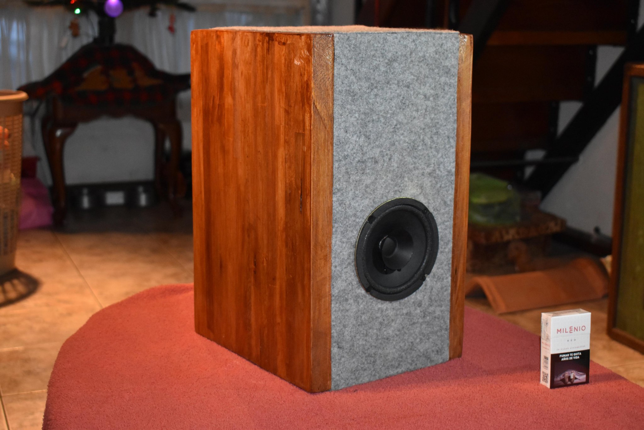

I'll offer up my choice...the NOS RadioShack five-inch Realistic driver with the appropriate sized enclosure. They are still available as NOS, cat # 40-1284(E). Mine sounds great, ...just now looked them up & Ebay has them for $18 each.
After lots of research, a seventeen liter enclosure with a one-inch hole bored into the back & overstuffed with cotton batting to work in an Aperiodic alignment works fine.

The outside dimensions as pictured, 243mm wide, 282mm deep, 420mm high. Now of course one needs to take the thickness of the wood itself into account...in my case, the outer "butcher-block", pretty looking stuff is kinda thick at 28mm...the stuff hidden under my...poorly executed carpeting grey stuff was thinner at 5/8 inch MDF. My reasoning was that smaller run of 243mm worth, minus 28mm & 28mm could stand to be a bit thinner. The thicker butcher block was the only "dressy" looking stuff I could find.Rick, those are interesting and certainly cheap enough to play around with. I may just pick up a set for some old Dual bookshelf speakers I have with a blown driver. Might make for a good shop system speaker!

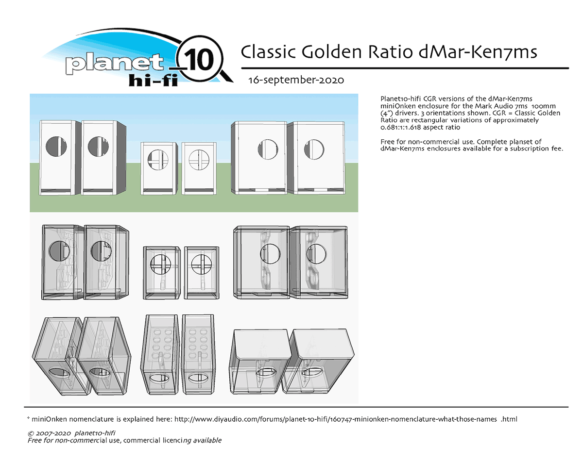

exactly how i start when determining the starting place for my Classic Golden Ratio miniOnkens. Justa start as the thickness of teh wood and the slot vent at the bottom make for some paffing about.

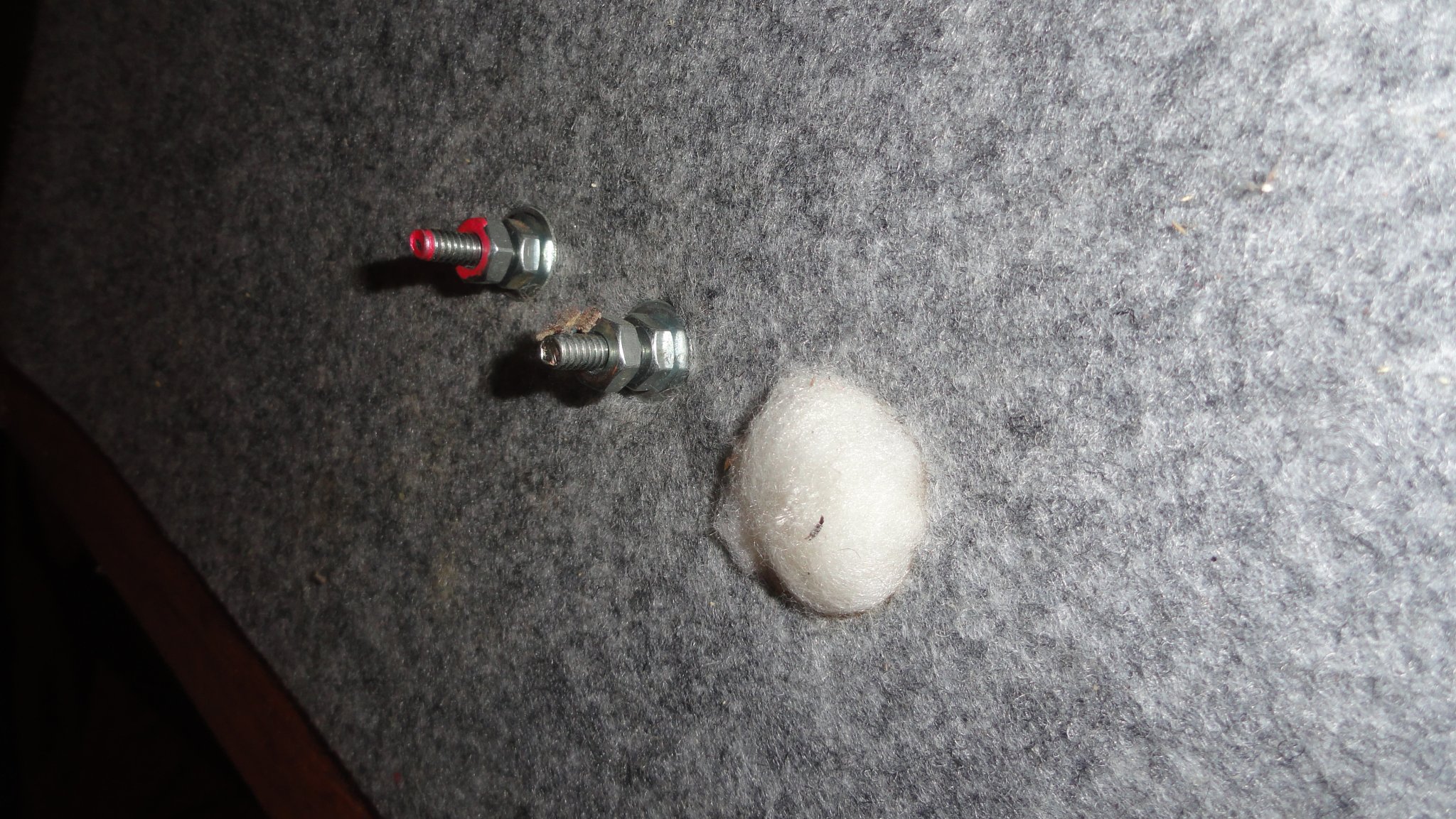

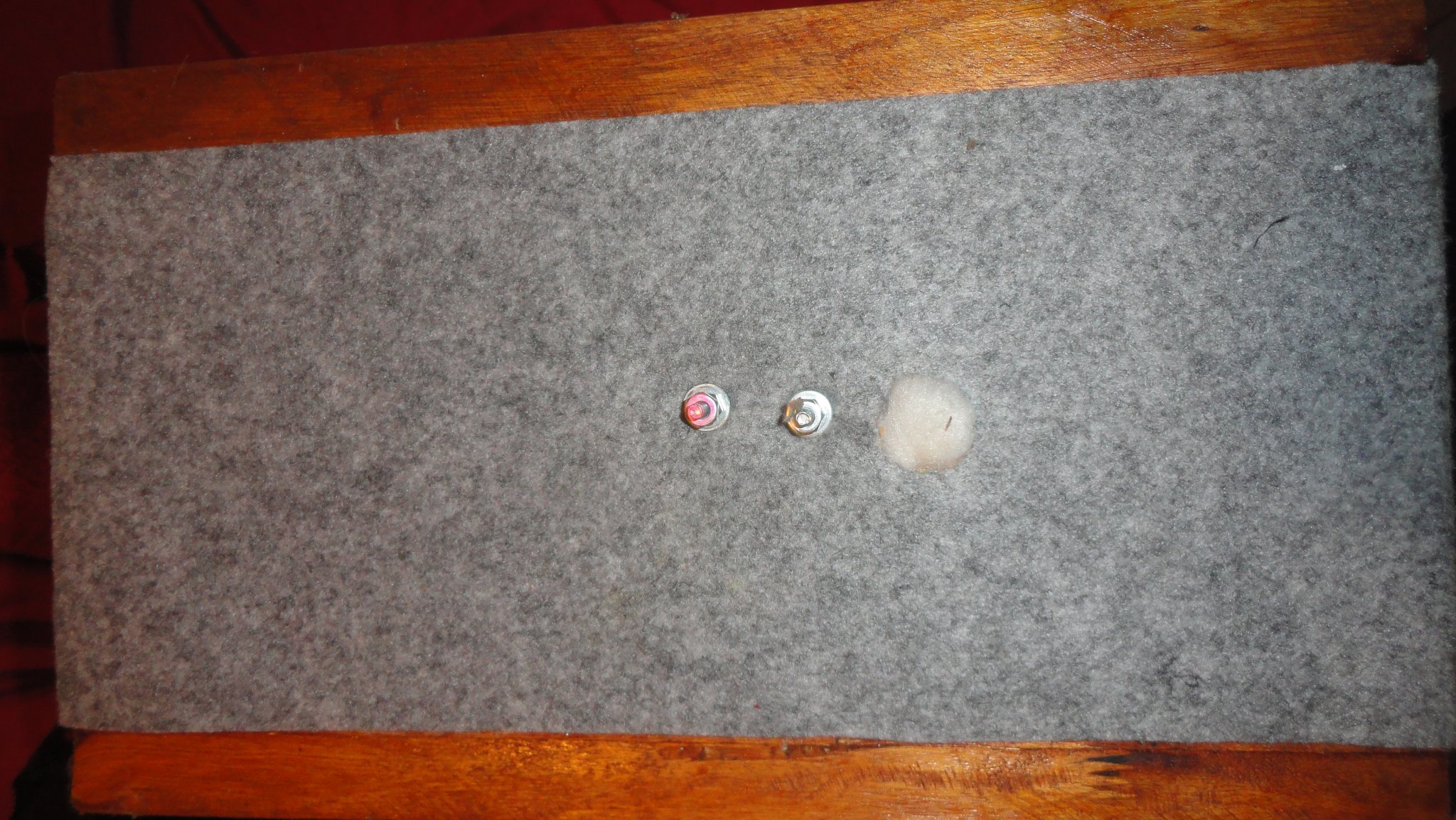

Remember to create a one-inch hole at the back & extend the stuffing thru the hole as to make for a "resistive vent", the aperiodic alignment.
