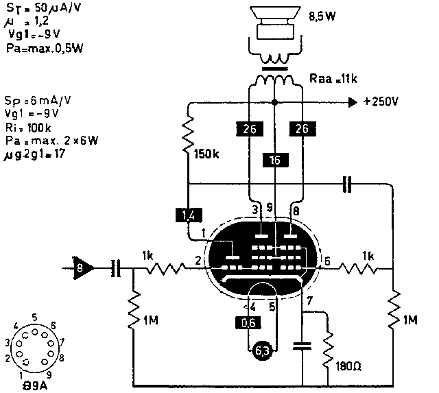

This is it, assuming that:
1) you've read the safety guide about the high voltages. Look at a thread here, in this forum, that's sticky.
2) you know how to build a 250V supply.
I personally would wire the pentodes as triodes... 😉

spektraldata said:The type and value of the condensateur...
0.47uF 400V polypropilene will do good, but in parallel of that 180ohm resistor use a 100uF electrolytic of good quality.
spektraldata said:The power of the resistor
1k and 1M ones will be good at 1/4W, 150k is better 1W and 180ohm will be I^2*R = 0.026*0.026*180 = so small, put 1W and your're fine.
spektraldata said:If i need and preamplifier wich one ?(to work with CD player)
Mmmmm I think you need one. You need a gain of 3 or 4... do a search for the various linestages you'll find on the net.
spektraldata said:A schematic of the power supply
That's easy.... do a search for the various power supply schematics of other amps, or try to design yourself.
spektraldata said:The 6.3V in DC or AC ?
Either will be good, however DC will be quieter.
spektraldata said:How many ampere for high voltage and hot circuit for one tube ?
You'll need about 70mA per tube (both pentodes and the triode), look for 80mA to have better regulation. The 6.3V supply has to be at least 600mA per tube.
spektraldata said:Can I test my tube before begin to build ?(i think no but...)
With a tube tester, yes... 😉
spektraldata said:I will put a tempo on high voltage...is it good?
You mean a time delay? That's good... it will make the cathode warm before applying the high voltage. It will longer the life of the tubes.

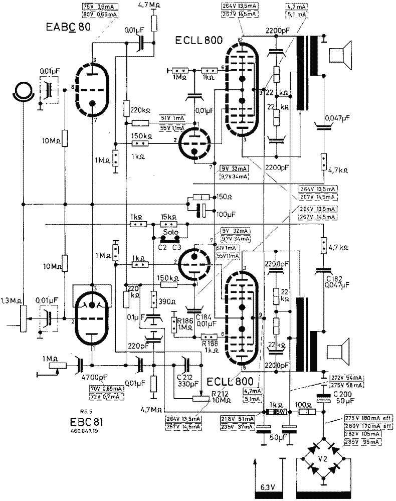

I have at least one schema for ECLL800 (and a bunch of the tubes). The amp i'm canabilizing used a 12AX7 variant as a driver.
The C in the ECLL800 is a unity gain phase inverting tridode stage to drive the grid of the 2nd tube. The screen grids are tied together inside the tube so you are limited to building a push-pull pentode amplifier of 6-8 W. If you have enuff gain in your preamp (ie something like 6-10 V (Bottlehead foreplay is a good example)), you could have yourself a 2 tube, stereo push-pull amplifier.
dave

This is the output stage from a Nordmende ECLL800 receiver.
I've been simplifying the channel at the top (nuking tone controls, etc). The feedback goes to the stage previous to what is shown. The triode sections of the mult-purpose front-end tubes are close to 12AT7/ECC81
dave
dave
Eli Duttman said:low distortion and reasonable damping factor require triode wiring
I don't think that it is possible to wire this tube in triode.
Also. you can only talk about reasonable damping when the speaker is included in the equation... speakers with XOs tend to want amps with higher damping factors/low OP imp, but many a full-range system will benefit from low damping factor/high OP imp.
dave
OOPS, I goofed! I locked in on the upper left corner of the schematic provided. That data is for the small signal triode. the PP power pentodes are good for about 8 W.
Dave D. (planet10) is correct. Because the 2 screen grids are tied together, only pentode mode is available.
I stand by my advice to find something else. I priced the ECLL800 at RES. They are 60 bucks each.
Leave that scarce and costly NOS for OEM replacement. A full set of tubes for "El Cheapo" costs less than a single ECLL800. 😀
