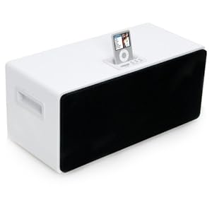

I got this old iphone/ipod docking station that I never use anymore. I want to modify it into a bluetooth speaker, but my knowledge on the subject is very limited so I decided to seek some help 🙂
- info on the back has it rated for a 100W total
- 2 smaller speakers and one big one
- it hums when its idle (hate it) and the radiator on the back gets pretty hot
- wooden construction
- I want it to be ON 24/7, always ready to be connected to
- as long as there is no humming when idle - cheaper = better. The station itself cost 20$ and I'm not very picky when it comes to sound 🙂
