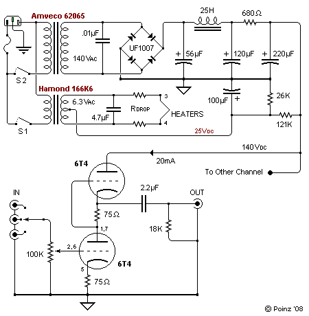

The Moebius looks very inticing, I think I will go for that.
I've changed my plans for this little project, since I own and run a recording studio out of my home I think ill try and make just a preamp for the microphones, no power amp. which means I wont need the 6CA7's. Anyone know where I can get 4 mounts for the 4 6AQ5's?
Oh and before I go for 6AQ5's im wondering if I should go with better tube's? perhaps some 12AX7's? Any suggestions on better preamp tubes?
I'll also need this to have balanced inputs & outputs aswell.
How can I add in transformer balancing to the in's and outs on the moebius schematic? What transformers will I need?

ummm, with all the little changes you suggest, suddenly you don't have a moebius any more... I think you need to more clearly define your design goals. Either this project is aimed at maximising the use of available parts, or you ar eprepared ot start from scratch. Either it is a pre- for a specific use (a microphone being substantially different to a CDP as a source) or its an integrated for pleasant noodling. Good luck - and welcome to the DIY toobies dillema!

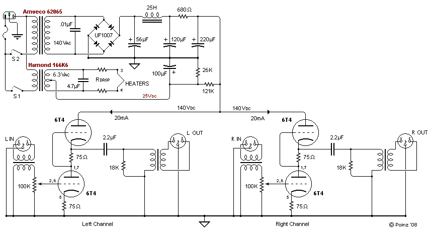

Ok, I've attached a modified version of the Moebius.
I'm not sure if this will work, kind of guessing. Do you think that would work for balancing? (this is the 6T4 version)
I'm also not sure what transformers to use for the balancing.
Also, i'm not certain if I would need any modifications to the power supply curcuit to handle 2 sides, left and right and the 4 tube's it would have to power?

To my knowledge it looks good except that I am pretty sure you don't need the 18k resistors on the output. Also I am sure it is fine but you could play a bit with the value of the cap on the output.
This is just off the top of my head for a 1:1 input (no additional gain needed) the LL1690 for input; LL1676 or LL1674 for output, Lundahl options. There are others out there more versed in low level transformer selection than I; also like I said, off the top of my head.

The transformer on the input looks superfluous to me, since the circuit takes a single-ended signal on the input grid. You might as well just connect whichever pole of the balanced input to the grid that gives you the polarity out that you want, and float or ground the other side as happens with the transformer. Am I missing something? I admit that I am inexperienced at balanced operation.
The 18K resistor across the output is the loading resistance. The circuit 'likes' to see 15-17K as a load for best sound. Lighter (higher) will sound a little tight and shallow, and heavier (lower ohms) will start to sound a little soft and 'tubey'. The 18K is for the standared 100K or so tube amp Zin. For guys who will be driving a sand amp with 20-25K Zin, I use a 39K or 47K there.
I mentioned in the other 6AQ5 thread that I have found The Answer for power transformer duty, the Antek AN-0232. It's a 25VA toroid with two 32V secondaries which will give 68-70V in series at our 7W burn. Voltage doubler rectification and the same filter, 135-140Vdc for the B+. It also can be used for any wall voltage, having dual 115V primaries. I'll try to draw a picture in the next day or two.

Do you need the 18k resistor though if the output is loaded by a 10k to 20k primary on an output transformer? I don't know for sure, that is why I am interested.

Whats the freq response of this preamp?
With the 6T4 and 2.2µF on the output, 10Hz - 200KHz +0 -1dB
Whats the max gain before clip?
This is a meaningless spec. The gain, under all circumstances, is ~6 (15dB)
Whats the line out? -10dBV or 4+dBu?
This is a pro spec, the meaning of which I do not know.
Whats the maxium output level?
Vg-k is 1.6V, so at the 6.0Av, the circuit will swing 9.6Vpk at the onset of soft clipping, or 6.8Vac (Vrms).
Whats the signal to noise ratio?
Hum + noise is constant at ~20-40µV (.02 - .04mV), depending on the individual tubes, so S/N will depend on signal level.
Whats the range of the gain pot? (in dB's)
Circuit range, with the pot, is from 0 output to full 6.8Vac output. In dB, of course, this would be approximately equal to infinity (minus the hum+noise value). This amounts to (in hi-fi terms) another non-spec.
