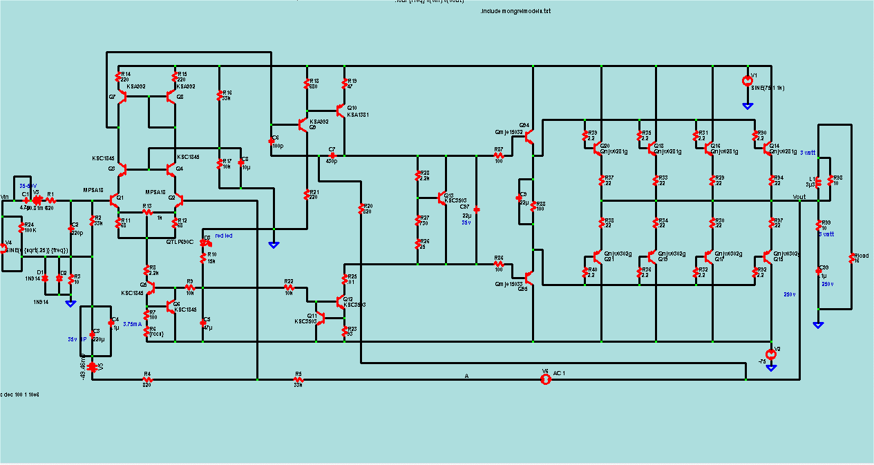

Hey ther...i'm new here....I'm a student in electrical engineering at college....i'm looking for a schema to do a 4 channel x 100w RMS for my car speaker....2 stereo IN...and 4 OUT

For real watts , you need a switching power supply (12V to +/- 40-50V).. this is typical of most analog OEM multichannel "blasters". The amps are typically LIN topology 1 or 2 output pair pair class AB.

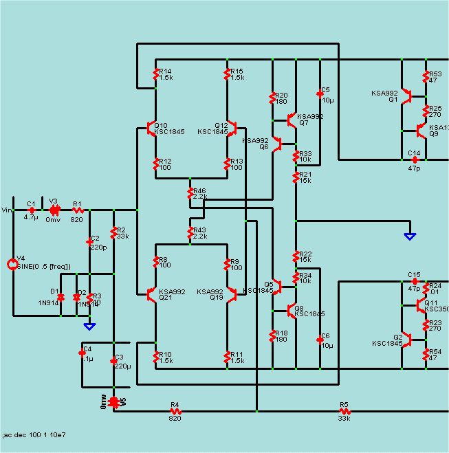

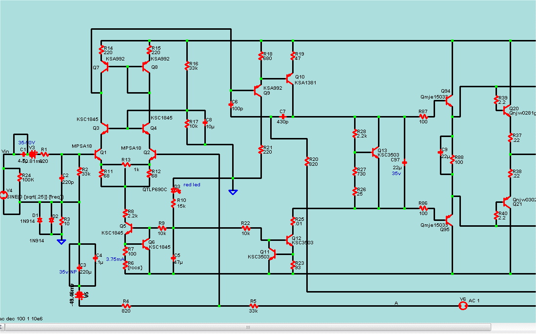

Like the dozens of Pyramid gold 100W X4 amps I have repaired , "LIN" is a typical car linear stereo amp design (below 1) , I have seen fully balanced designs , too.
(below 2).
Add 4 of these to a hefty switching supply (SMPS) and you have your 4-channel "blaster" 😀
