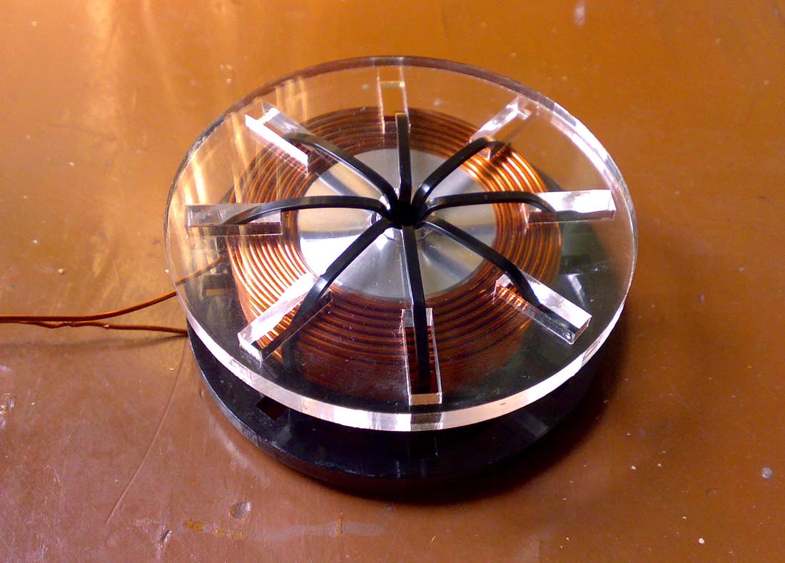

I can wind for you
will look like this but bigger:
