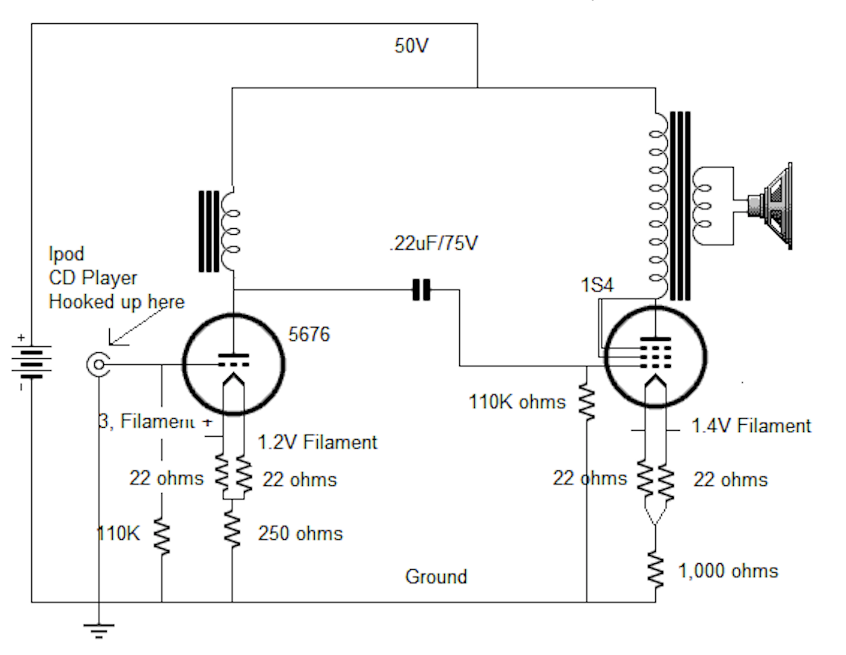

Here is an amp my son built for a science fair. We tried to generate B+ with a huge array of potato, lemon, or combination or both batteries, not entirely successful, well not successful at all. With traditional batteries it worked fine. The output transformer was an old Radio Shack #32-1031B, choke was Hammond 156C.
I don't know if your goal is small or just battery. For small you may want to try Russian subminatures like, 1J17B, 1J18B, 1J24B, 1J29B all DHP. 1S38A and 2S14B are DHT. Then there are U.S. tubes like 5676, CK512AX, 6088, etc.
Stevie Bench has a variety of battery suggestions <http://diyaudioprojects.com/mirror/members.aol.com/sbench101/#Battery>
Edcor XSM or similar work fine as series outputs if plate current is under 3ma, as do most small distribution transformers. Battery powered amps come up regularly on this list so search away.

Nwibie, that 1s4 schematic I think is to weak to drive headphone, I’m thinking bigger output than 6as7.
I think the key is to find the right tube.
Recommended power is 250mW for something like the LCD2 and it's a 70 ohm headphone. That's 4.2V RMS. If we assume that you order a 10K:70 output transformer to go with the 3S4, that means a voltage step-down ratio of 12:1, so you'll need to swing 50VRMS at the plate of the 3S4.
50V RMS is 70V peak, the max plate voltage is 90V. Since there's a hard stop on the plate curves where the 0V grid voltage line is, we can conclude that delivering 250mW is pretty tough with the 3S4.
I would suggest using a different set of headphones or not using batteries.
