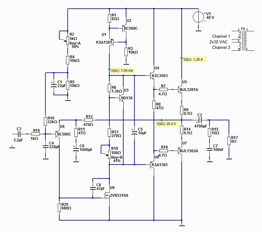

If you want something really unusual, here it is:
-https://www.diyaudio.com/community/threads/tandymos-is-not-your-typical-amplifier.390272/post-7122175
More classical:
-https://www.diyaudio.com/community/threads/a-collection-of-vintage-single-supply-low-to-medium-power-amplifiers-for-daniel.335079/post-5724404
More examples:
-https://www.diyaudio.com/community/threads/old-fashioned-amplifiers-with-a-new-twist-1.337017/post-5768643
-https://www.diyaudio.com/community/threads/easy-mos-is-a-simplistic-efficient-and-evolutive-all-mos-amplifier-for-beginners.336797/post-5763844
-https://www.diyaudio.com/community/threads/old-fashioned-amplifiers-with-a-new-twist-2.341721/post-5890688
