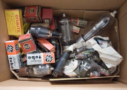

I was cleaning out some of my grandfathers stuff this weekend and found about ten boxes of tubes! Lots of different stuff. 12ax7 12au7 6l6 813 are the only ones I can remember off hand. A few cool looking tubes with mercury in them. I am not sure what they are. Rectifiers? Then I found some really big ones. Three 4 1000a's a 4 400a and four 4 250a. Anyway I have always wanted to build a tube amp. So no I have no reason not to🙂 Here is a pic. from one box.

You are a lucky ****!
I'm jealous
This is like finding a treasure with an old map 😀
The ones with mercury are most likely rectifiers. Be careful with them, both mechanically and electrically!

Congratulations with your find🙂
Mercury rectifiers, I think I read some place the they should be kept vertical for a couple of days before applying voltage to them..not sure why, maybe the mercury in the wrong place could make a short between anode and cathode?

Sort of - they need to be run on filaments only for a while (the interval varies from data-sheet to data-sheet). I reckon 15 mins to 1/2 hour should be fine. And yes, it is to make sure that there are no blobs of mercury to cause a short.
