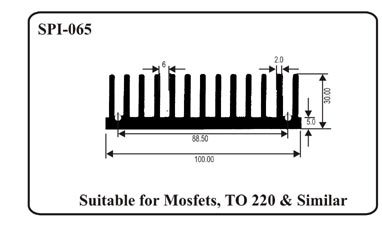

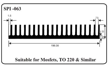

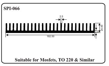

Hi all,
i have been posting various questions in these forums about an F2 build i am starting. when i actually begin i will start a build thread for all my questions but for now i am buying parts and have a question regardin heatsink choices.
the extrusions available here (in Bombay, India) all have horizontal fins. i can turn these on their side and make the fins vertical but then my heatsink length is limited to the width of the extrusion.
How much of a difference does it make if the fins are horizontal?
i am thinking of a length of about 14 inches. the heatsinks will make up the sides of my enclosure. can you please look at the images i have attached and advise.
thanks
mymindinside

this is the width of the sink, i can get it any length i want, i was just wondering about the horizontal fins
for eg: if i choose the spi-063 then the width of the heatsink is 7.7 inches and the length is 14in (or any length i want) with the fins running horizontally.
the F2's rated power consumption is 75w/ch. is it correct to assume that most of this is dumped as heat through the sinks?
Maybe i should articulate my question better: should i look for longer thinner fins that are closely packed together, or thicker fins that are farther apart? is it better to have a thicker base?
one device dissipating 37W on a 14inch length of 063 might just run cool enough.
If that did work, then you would need four 14inch lengths for a stereo amp.
The basic problem is that all the sinks are too thin, the 063 is only 7.5mm thick and that restricts good conduction out to a 75mm radius from the device. The sink beyond 75mm gets colder the further it is from the device.

Yes, that extrusion looks good. One 6" piece per fet should be good.
Two 6" pieces side by side is much more efficient than one 12" piece on it's side.
The Conrad website has a very good explanation for understanding the relationship between dimensions and capacity.
