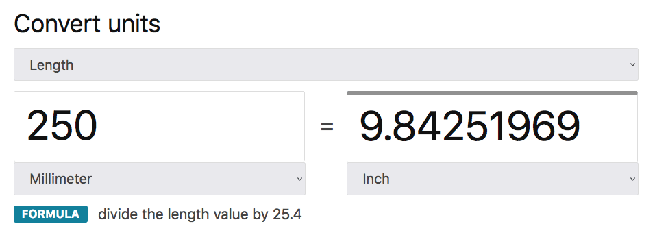

I don't know how high you are, but an effective 250mm ceiling height puts you in the garden gnome height range 😉
