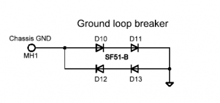

if the hum goes away with a cheater plug on the amp or preamp....this virtual cheater plug will work without posing a shock risk. it acts like a cheater plug for normal ground loop voltage levels but once the voltage goes above the diodes forward volts...the circut transistions into a ground preventing the shock hazard.
