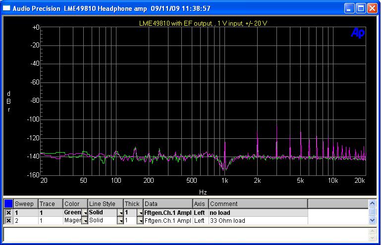

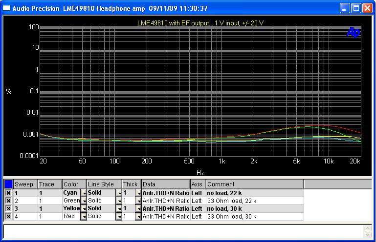

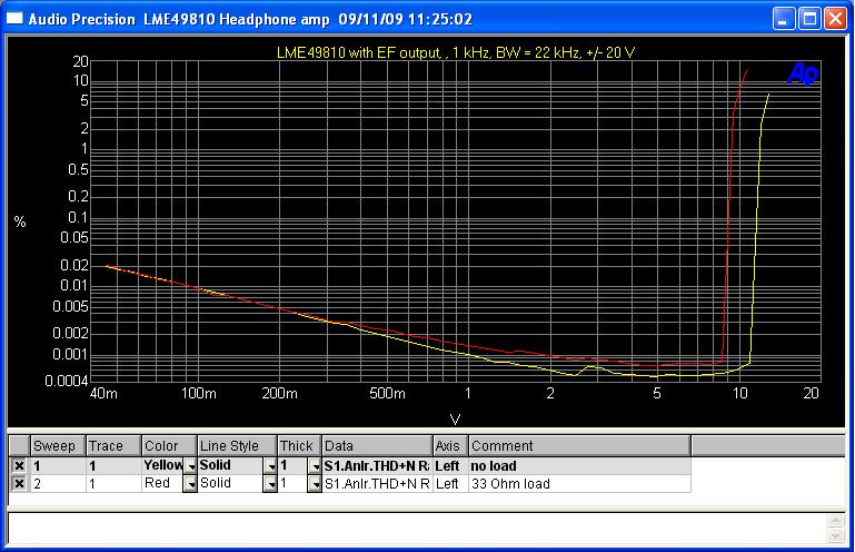

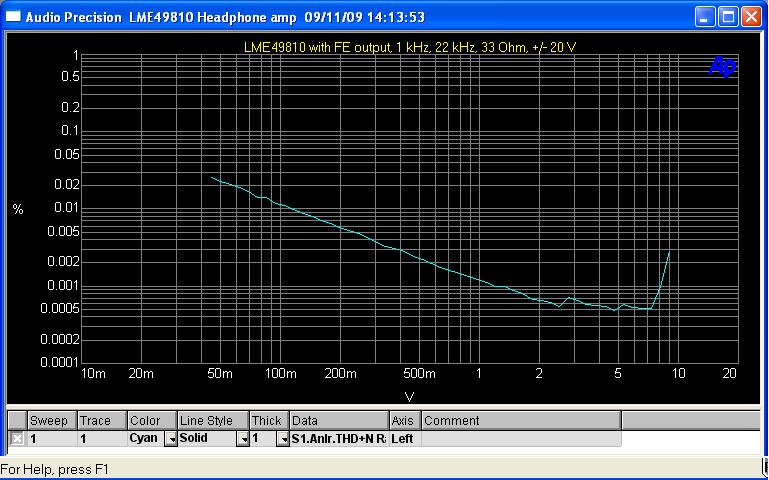

I simply wired up a simple EF output stage (10 Ohm emitter resistor) using MJE15030/31. Output BJTs are biased at 2.8 mA with a 500 Ohm pot connected between BiasP&M. This bias level is not sufficient for class A operation for practical headphone loads. Higher bias level will be evaluated later.
Here are some test data.
Rails: +/- 20 V from a test bench supply

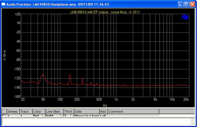

Output noise level: 9.5 uV (22 Hz - 22 kHz)
Output DC level: 0.5 mV

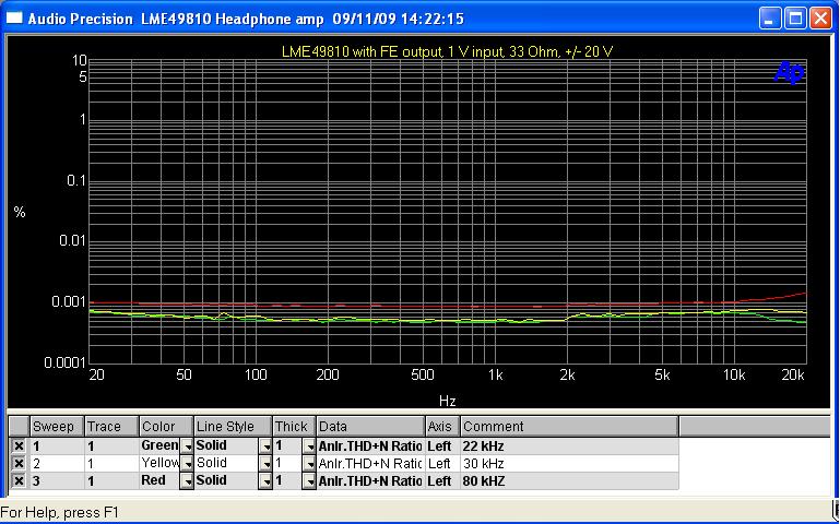

I changed the pot trim to 5 K by which bias level can be increased. At 100 mA idle current, the performance is super! Output noise slightly increases to 12 uV (22 Hz - 22 kHz). With 400 Hz high-pass filter inserted to filter hums, it reduces to 8.2 uV.
I run the tests for rails +/- 15 V. No noticeable problem observed.

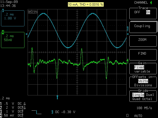

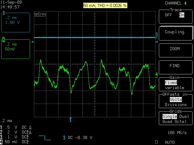

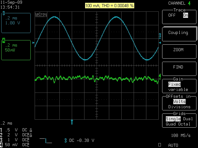

THD+N residual for various biasing points. THD+N is very low when bias current is 3 mA. It does not decrease but increase by increasing the bias. Is gm-doubling (D. Self) causing higher distortion in 10/50 mA?
