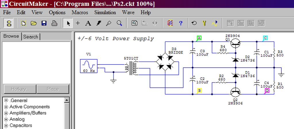

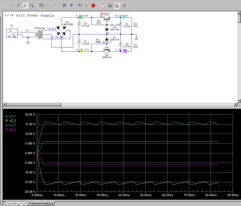

If you have the parts in your junk box you can use this simple little circuit and use some 15V zener diodes in the place of D1 & D2
Notice the load resistors R1 & R3, without these spice will fail the sim.
jer 🙂

Thanks, I do have LM317 and LM117 regulators. I was hoping I could do a simple power supply like on power amps but the voltage here is all over the place so better safe then sorry.
The 1 advantage to making my own power supply is I don't need a magnifying glass with light to solder it up 🙂
This pre amp board is tiny.
You could use a single positive regulator but you would have to setup a virtual ground system.
Or get a LM337 the negative version of a LM317.
If you have any of the LM78xx or 79xx regulators these can be made to regulate at higher voltages as well by adding a resistor to the ground and pin2 common input pin.
What this does is it raises its ground reference level to a higher voltage above ground and will still regulate but at a higher voltage.
