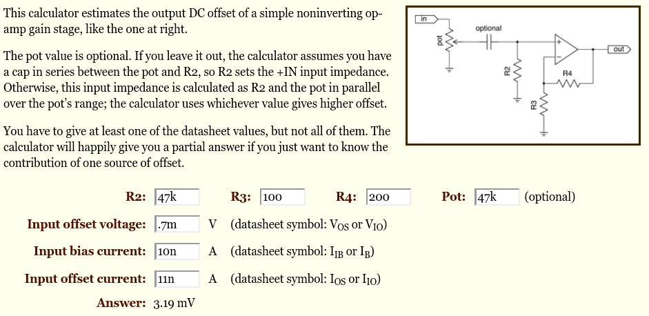

I was using an offset calculator with the typical and maximum values supplied in the 49720 data sheet. Based on the typical values, offset was a bit under 4mV, and just under 10mV with the higher max values. I thought these were rather high. Maybe I made an error or this calculator provided an incorrect answer? Electronics Calculators

Both pics show R2=47k and R3=100r and R4=200r, R3||R4=66r7Thank you for your response, Tom. The servo circuit in the 49600 opamp headphone driver is helpful and illustrates its application very well.

Those values in the images were based on suggestions I found online for 3x gain. I haven't found any clear answers to what should be ideal for low offset with gain. That's what led to this thread. The most common suggestion is low feedback resistor values. Douglas Self used 2k2 and 1k during his testing of the LM4562 at 3.2x gain. He never mentioned his output offset during testing but his values give the same high offset results in the calc. (According to TI product managers, the LM4562 is the same die as the LME49720 so results should be interchangeable)
I'm looking for a way to minimize offset current differences or the effects. If a DC servo isn't a good way to correct DC offset in a line level gain circuit, how does one minimize the offset directly? What values or additional circuitry correct any offset?

An opamp, or an amplifier, that uses differential input requires that the INPUTs to the circuit match for voltages and currents.
This requires that the INPUTS require to see the same resistance.
Your +ve input sees 47k plus some parasitics.
Your -ve input sees 66r7 plus some parasitics.
This is because you have a mixed AC & DC coupled amplifier.
Change the circuit to AC coupled and your problem of unmatched input resistances can easily be solved.

A side effect of unmatched input resistances is an increase in drift of the output offset.
Not only does mixed AC & DC coupling increase the output offset, it also increases how much that offset changes, particularly during warm up and/or from season to season.

Thank you Andrew. That information allowed me to reduce the model's offset by 70%. Applying a voltage on the appropriate input could zero it, but as you say, an output coupling capacitor for AC coupling is safest and easiest at line level.
