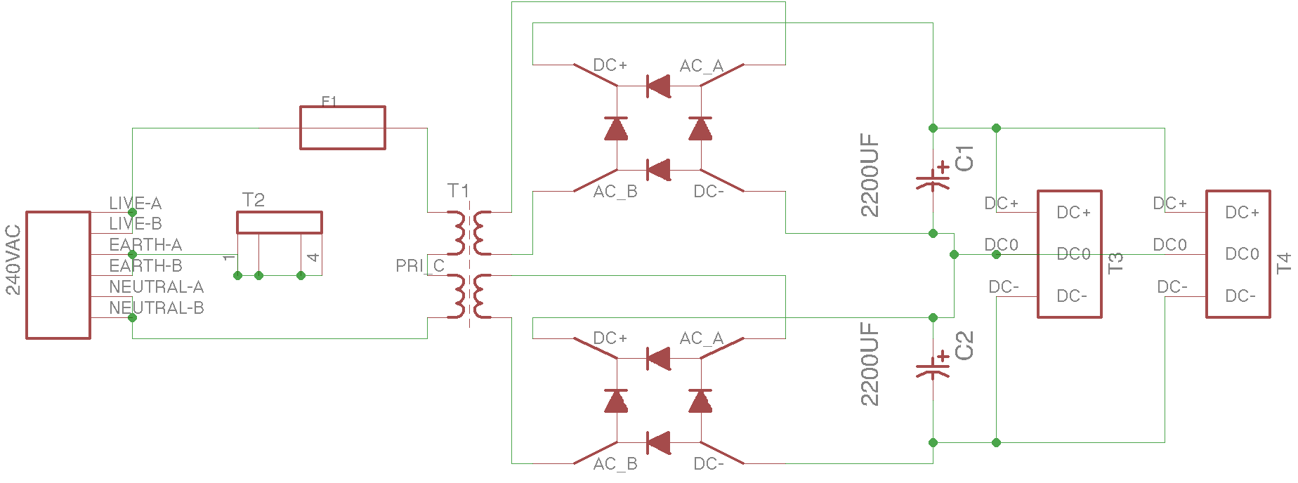

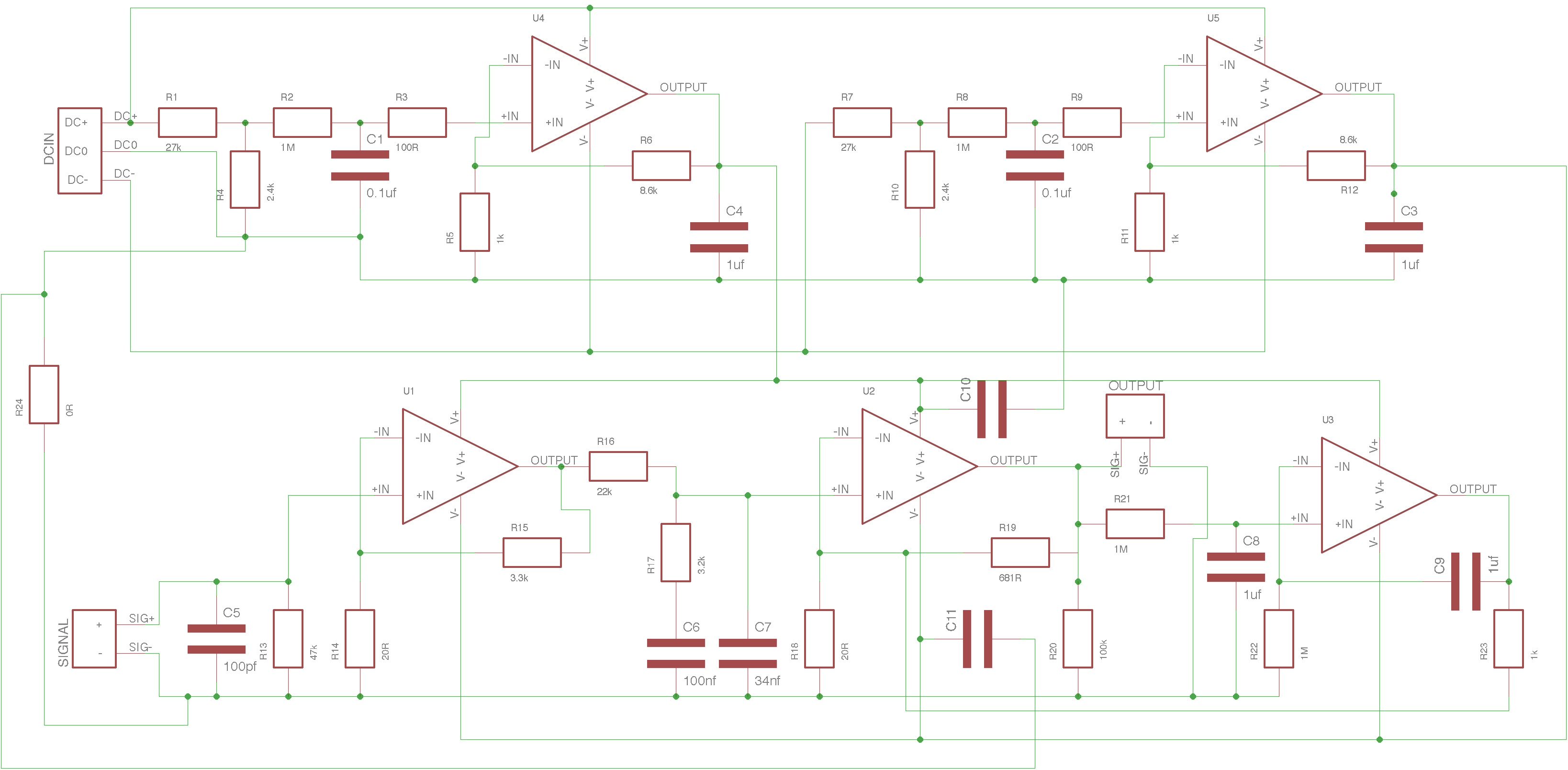

I'm going to build a version of the passive eq phono amp described in section 3.1 of this TI application note. The only deviations I'm going to make to the circuit are to reduce the gain of U1 and use a 47R and 300pF across the inputs as I use a MM cartridge.
The amplifier circuit includes U4 & 5 to 'flatten' impedance on the supply rails so I assume I can go for a pretty simple power supply (schematic attached), I've based the design on the following components:
Trafo
Bridge Rectifiers
Caps
My question is does this look like a sensible choice? I'm pretty new to this so I'd be grateful for any advice.
so I assume I can go for a pretty simple power supply.
You will want regulation after the filter capacitor for a phono preamp.
Thanks, I was wondering whether I'd need to regulate... plus that means I could go with a higher voltage trafo and regulate down to 15V rather than undershoot.
Yes, in fact I'd use a CRC filter before the regulator, to reduce the input ripple.
With these op amps, be sure to use good layout and local decoupling.

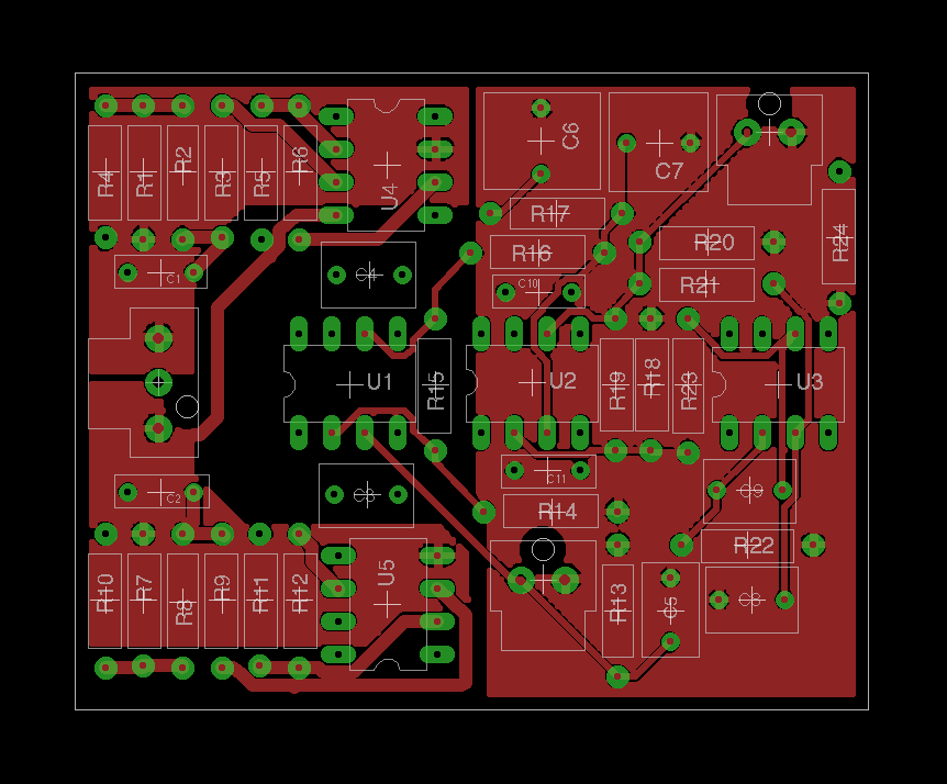

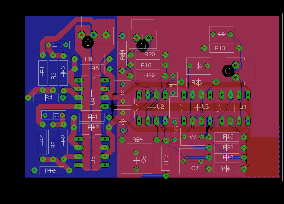

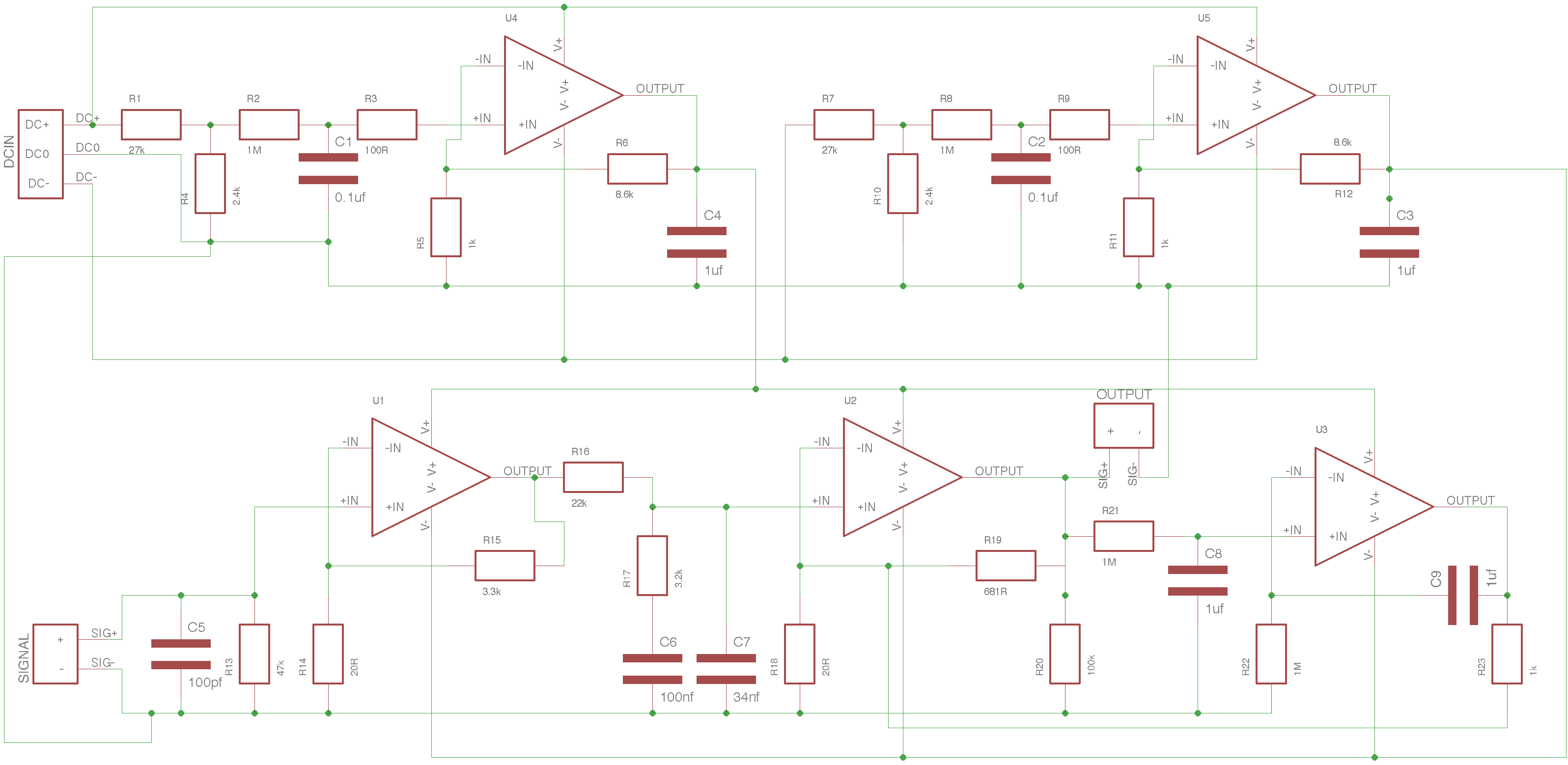

As for layout of the amplifier, I've had a stab by making a direct copy of the TI schematic in eagle (which I need to update the gain and input R&C for). There's no local decoupling... ideally I'd like to experiment but I need to work out how I can do that.

Unfortunately I get 37VDC after the regulator with that which rules out a linear regulator and I've no experience with switching regulators.
(assuming you meant 'rectifier' here where you wrote 'regulator')
If you choose a variable regulator like the venerable old LM317T then 37V input isn't a problem if your output is 15V (or so). The regulator is specified for a maximum input-to-output difference of 40V. Shorting the output might cause you to exceed that difference though - I'd put some resistors in series (as already suggested) prior to the reg's input terminal to mitigate the risk.
Doh!.. Yep I meant rectifier. Thanks I'll take a look at those regulators.
The supply buffers have a 1uF capacitor at each output. Arrange the placement of the buffer and capacitor
to be close to the supply pin of the RIAA op amp. Also add a parallel 0.1uF - 0.01uF directly at the supply pin.
Yes... of course, thanks. I was looking for decoupling caps at each of the op amps and missed the obvious. I'll shuffle things around and see how close I can get them.

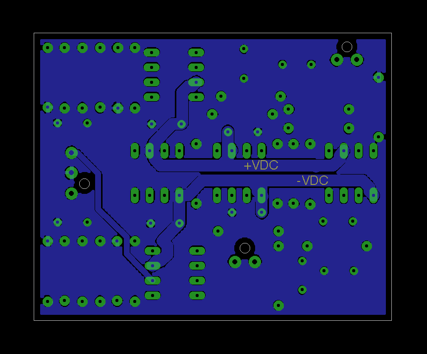

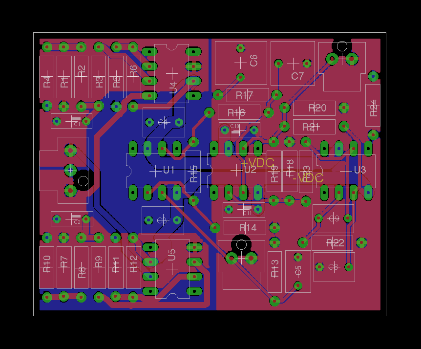

Thanks for the advice so far... I've reworked the schematic & layout as suggested by adding two pours for the power supply on the bottom layer and moving things around to get the RIAA op amp closer to the buffers & caps. Does this look like an improvement?
I'd place the op amps in line: U1, U2, U3 (servo). Then place the buffers U4/U5 above and below U1/U2,
with their output capacitors between the buffers and U1/U2. A very direct supply connection is necessary.
Then route these power supply connections first, before adding more parts. Something like this:
--U4--------
--C4--------
U1--U2--U3
--C3--------
--U5--------
Thanks rayma, I'll have a go at re-jigging the layout. I find it difficult to know what to trade off in the design: keeping the feedback loop short; separating the supply voltage from the signal etc. When I was doing the layout for the LM3886 it was (eventually) possible to separate the DC from the signal, decouple right up against the IC and keep the feedback loop short... with the five op amps in this design it's not so straight forward.
Several tries are usually necessary to approximate a good layout. Always start with the most critical paths,
i.e. the power supply and minimizing the op amp's inverting input connection lengths.

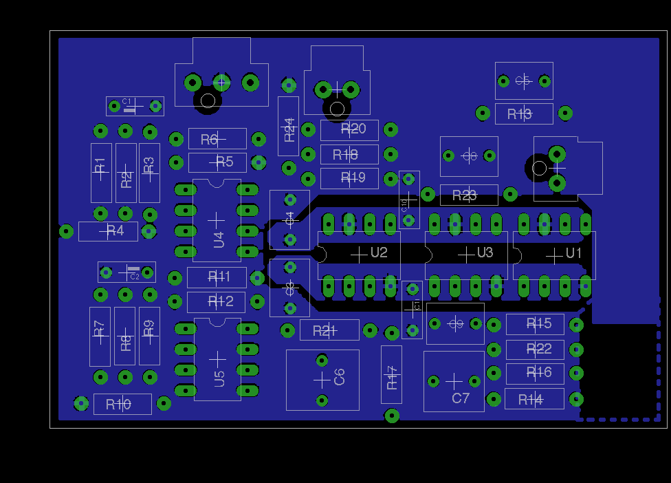

That sounds like good advice. I've had another go, I think I could still move U1,2&3 over to the left a bit more to get U2 closer to the supply caps but I'm a bit concerned about putting more distance between U1, the input and the RIAA network. Plus I'm not totally happy with the pours but it seems like a step forward.
Keep playing around with it, you'll get there.
I guess U4 and U5 are meant to filter the supplies. I'm not sure whether they will remain stable with C4 and C3 as a load. If C4 and C3 are ordinary run-of-the-mill electrolytic capacitors, their effective series resistance will probably help to keep U4 and U5 stable, otherwise you may have to insert small resistors between U4/U5 and C4/C3.

Hi MarcelvdG,
I think that the following extract from application note is reference to U4 & U5:
"the power supply rails must present a low and more importantly flat impedance across the audio bandwidth to preserve the audible spectral balance and overall integrity of the input signal. The PSRR of the LME49710/LM4562 is outstanding across the full audio bandwidth and therefore is highly immune to power supply impedance discontinuities. However, given the low level signals provided from moving coil phono cartridges, the effect is more pronounced and therefore the impedance of the supply rails is addressed in this application."

OK, if you got that supply circuit from an application note, whoever wrote the note must have checked the stability.
