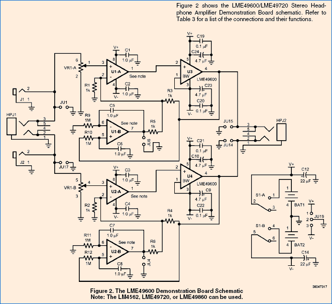

I guess it is something like this you use.
This is the circuit for the special
LME49600 HeadPhone Amplifier Evaluation Board.
A board that can ordered.
Almost same circuit is in the LME47600 datasheet.
Power supply is from +-2.5V to +-17.0V.
Supply current may be a bit lower for lower Voltage supply.
Supply current will be like 50% when using lower BW.
But of course only for the LME49600 chips.
Not for the opamps.
LME49600 is rated +-250 mA output. ( +- 0.25 Ampere )
But shortcircuit Current is like +-500 mA
At higher voltage Supply we should be more careful not to put out too much current.

The LME49600 offers a pin-selectable bandwidth: a low current,
110MHz bandwidth mode that consumes 8mA and a
wide 180MHz bandwidth mode that consumes 15mA.
