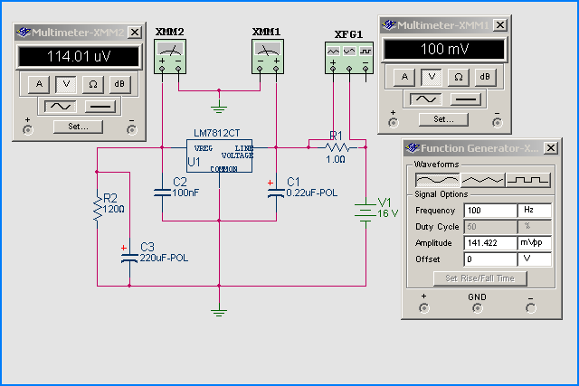

Trying to figure out how to setup
Power Supply Rejection Ratio = PSRR testing
using my Multisim spice simulator.
Have a look at my attached test circuit.
1. I am feeding 100mV ripple 100Hz onto a 12V regulator input.
2. Then I measure the AC voltage at the output.
3. In this setup I use 100mA DC load with a normal electrolytic decoupling capacitor.
Result:
Ripple at input: 100mV
Ripple output: 114uV = 0.114mV
Ratio: 100 / 0.114 = 877
20 x LOG10( 877 ) = 58.8dB
PSRR = 58.8dB at 100Hz ripple ( with ripple level 100mV )
This looks as a value that may be correct and valid.
Questions:
->> Is this a good method of estimate PSRR?
->> What setup do you use?
->> Is there some standard method used for example by Op-Amp manufacturers?

OK! Never mind!
You understood what??
You're the only one diyaudio amateur constructor that actually design your amplifier using Electronic WorkBench!
Maybe it's the reason why people ignored your "discovery"! Nobody cares about PSRR "measured" with a sim!
You talk about music you can hear and loose time with EWB ....stop sims and connect a "real" function generator and a "real" oscilloscope to your "real" 7812 connected to a "real" circuit! You will discover parasitics, oscillations and other "real" things
Good luck with your beloved simulations!

Mrjam is right, in EWB measuring 7812's PSSR means nothing. Measure it in your Lab. In such a serious laboratory I'm sure you have the needed gears. I'm sure you have a really nice workbench.

Hi lineup,
1->> Is this a good method of estimate PSRR?
2->> What setup do you use?
3->> Is there some standard method used for example by Op-Amp manufacturers?
1- yes!
2- the same, but you can "save" R1.
3- I don´t know but why not,
may be You ask Bob Pease?

You can just capacitively couple your AC signal to the supply voltage as is shown in this diagram: http://i.cmpnet.com/eet/news/03/july/SS1278_ADI.gif

Hi, Lineup
I have visited Ur web, it's interesting, I want to know what's the purpose of Ur Lab, for business, for fun, or an ad.
anyway, we do what we needed. the way to measure 78XX is not important, the point is we buy a component that can meet our application is enough. Too precise is a waste. We only consider price verse perfomance. any component manufacturer can provide spec. for their products. no necessary to do extra work on testing.
I've been using the 78XX series regulators for decade, and they gave our performance is over their value. to measure their spec. is meanningless.
