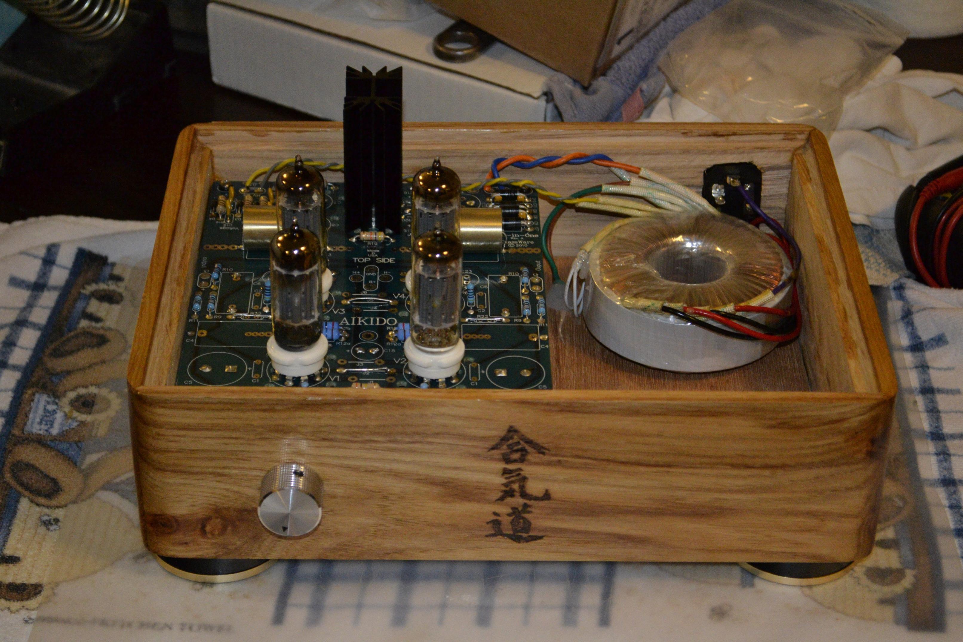

I have a 6CG7 Aikido Preamp.
The drive stage has +20.5db gain and the follower stage is -.6 db gain.
This gives me a total of +19.9db gain, there are also losses in the circuit to give a net gain of around +19.5db.
I can change the tubes around but that would require voltage changes that I really don't want to mess with.
From what I understand an amp gain of 30.5db was chosen as a good level for being driven from a modern CD player with a volume pot.
I would like to maintain that same total gain.
This would probably put me somewhere around 11db gain for the LM4780's.
