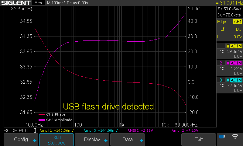

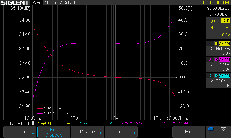

I assembled it and tested with a bode plot at 3 different input levels. The frequency response seems OK at each given input level, I see a slight phase shift, but of concern I see about a 4 db loss of gain as the input level is increased. I don't have a large enough resistor to test at higher levels, only went to about 8 watts. Should be able to go to 30+ watts in which case the gain loss would probably be even worst.
Amp[1] = input PPV
Amp[2] = output PPV
RMS[2] = output RMS V
Amp[1] = input PPV
Amp[2] = output PPV

i am not sure if i understand your plots correctly. the last - pic 3 is about 8Watt (7,5W) into 8R load. ok fine - you requested about 10WAtts-right?
you transformer is a 36CT - is 18-0-18VAC is after rectifier about 26VDC per rail.
so about the power - you have 7,73rms --> Vout peak is 10,9V --> so out pp 21,8V sin wave so you have some head room to go higher until clipping . i guess that 26VDC rail drop down to something like 23V or so- so with a bigger load resistor you should can go up.😀
pic 1 - 2 what do you mean with PPV-
purple pic 3
that means the purple line shows the frequency response and i can´t see 3dB loss? - at the low frequency you have a "loss" just about 1db 29,85 down to 28,85dB - this is not bad!
the amp input is 712mV rms and output is 21,8Vrms that give a gain about 30,6 and its about 29,6dB. i would change the gain setting down for less hiss. Rf in the datasheet (pin3-7 and pin1-12) is 20k ohms - i guess you have about 30k there...

Sorry my brain was working backwards I meant VPP not ppv or volts Peak to Peak. What I meant was at low input voltage in the first picture of the gain is approximately 34 db where 3rd photos the gain at a higher input voltage is about 30 Db. Test resistor was a 10-ohm 10 watt resistor. Another interesting fact about this kit the input impedance is only 1 K ohm.
ok blackICE...no problem...🙂
hmmmm. ...different input voltage and different "gain"......no idea why this happend
chris
