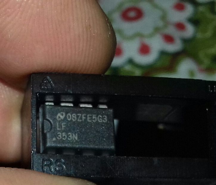

I grabbed some LF353 too, The National version of TL072 but yet to compare both. Now I have other works to do.
