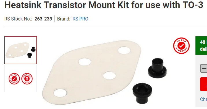

this is s TO3 mica and nipple image, only to show what nipples look like .
Important: nipple goes through both transistor/chipamp flange, AND through mica AND often into a 4mm or so hole drilled/punched through heatsink or chassis, and screw goes through it.
A common screw size is 3mm metric, maybe there is some crazy Imperial or American size matching that but you can´t go wrong with Metric.
Notice nipple acts both as a shoulder and a sleeve which always separates screw metal from heatsink and chassis.

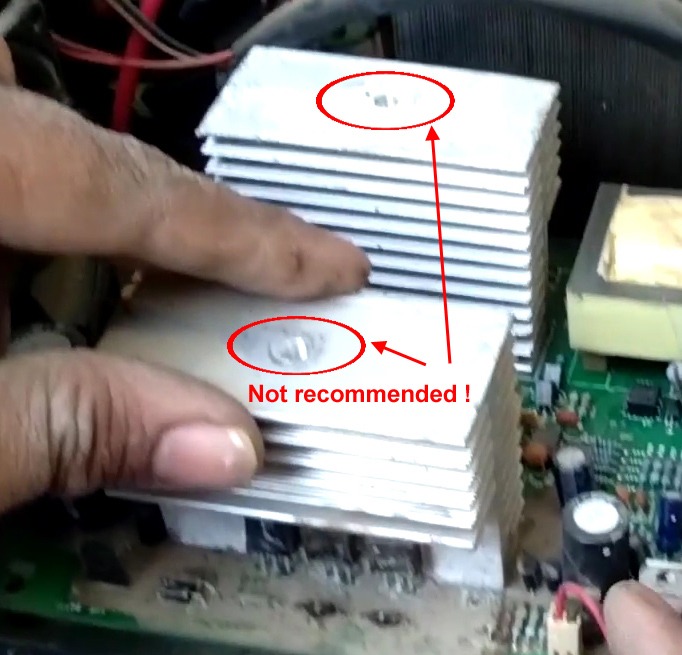

Dear archeo,
Do not connect the heatsink to any potential other than Earth and keep it isolated. Now I just feel like I shouldn't have written post #12. #12 was intended in a particular case where the amplifier chip is to be operated on a single isolated supply, whose VEE would then be already grounded.
And, even if one chooses to do otherwise (for whatever reason), power entry must not be made by means of an electrical connection to the heatsink (as in the inverter board shown below), as any HF noise present could then transmit into the air using the heatsink as an antenna.
Another reason you don't want to conduct power through the heat sink is that the IC likely does not have a bond wire from the die to the DAP (die-attach paddle). So while the DAP (that metal back of the package) is electrically connected to VEE, it's not likely to be a very good connection. It may simply be the die substrate connected by a dab of conductive epoxy. Conducting power through a power pin is much better.
