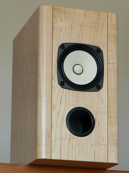

Have you had a look at the pics I sent you of the FE127E speakers?
Chipamp junkie eh... Aside from the GK-1 / AKSA combo nothing else (so far) has really grabbed me 😛
Yep, seen the pics. Who built them... No really... who..? hehehehe 😛

I will have to admit, the chipamps have gotten to me as well the freaky things. The AKSA combo I have certainly has the edge and is more versatile on harder loads but chipamps always bring a smile and make the foot tap.
It was me... I built them.... me.
