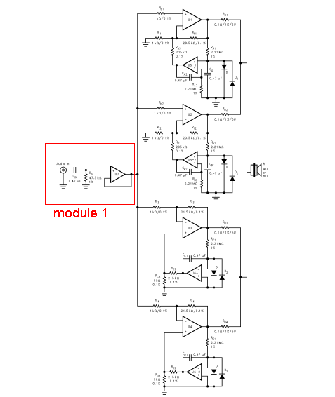

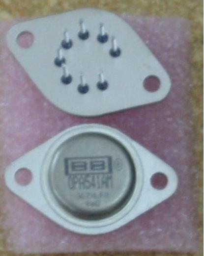

TI's OPAs have quite some current drive. Maybe the OPA541 (a bit edgy) or the 549 (more laid back).
BTW, which is the maximum current of the LM3886?

The 3886 is spec'd for a maximum current output of 11 A. This is stated in the datasheet under Application Information. Note also the Safe Operating Area curve. which shows the maximum cureent for various collector-emitter voltages (basically the difference between the power supply voltage and the output voltage at any given instant).BTW, which is the maximum current of the LM3886?
To the contrary, the 3886 is practically designed for 4 ohms. It is rated to put out more power into 4 ohms than into 8 ohms. The 3875/3876 on the other hand, have a much lower current limit (4 A vs. 11 A for the 3886) and a lower maximum power (heat) dissipation (100 W vs. 135 W for the 3886). The 3886 is a much more robust device than the 3875, and for high-power 4 ohm applications is a better choice.heard that lm3886 don't like's 4 ohm
i looked to lm3886's pdf and found that it can output around 90w at +/- 35 with 4ohm .If somebody used configuration like this please write how it worked(sound,heat output).
At $100+ each they better!!! Why not parallel a few plastic units at $12 each?Hybrid fourdoor said:These guys will probably put out 80W no problem.....

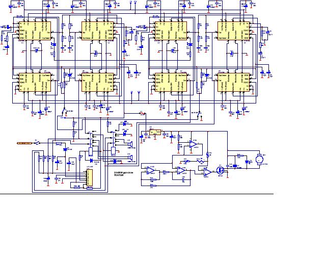

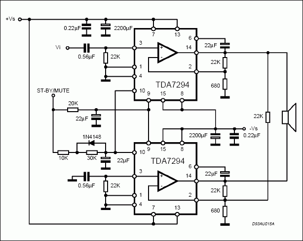

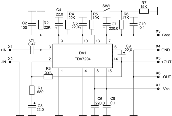

finaly i built tda7294 amp but now i need to know is this circuit is good
one week ago i built tda1514 bridge ,but i asked is my tda1514 bridge circuit is good everyone wrote that it was fine ,but after when i built amp i realized that it wasn't working then somebody wrote that in that circuit pins were mixed and tda1514's fried
now i want to build bridged tda7294 please look at this circuit carefully.I'm new in electronics ,but i think that everything is fine here ,but it would be very nice to know that professionals think so too😀
ok, if i make this tda7294 bridge circuit would i need more things like higher power preamp or something else.And about the circuit is it realy good???????Pins realy aren't mixed?????????????????????

abidr , could you email me a bigger picture, please?abidr said:LM3886 is rated at 68 Watts, whereas 729x is rated at 100 watts, be very very careful with the bridge chips will blow up short to ground, short to supply etc and u ll be mourning like frying up of 1514, but it sounds good.
Try Attached one.
You will find the email address at my homepage.
Thanks.
