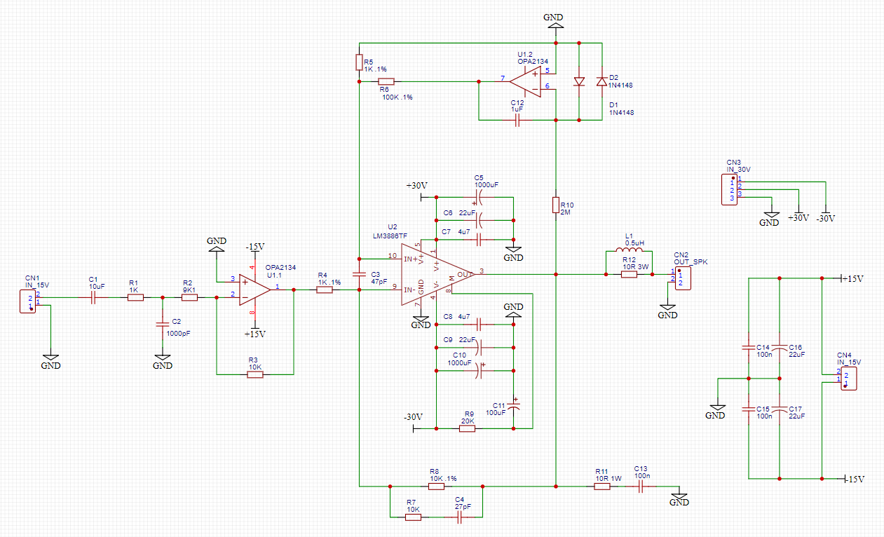

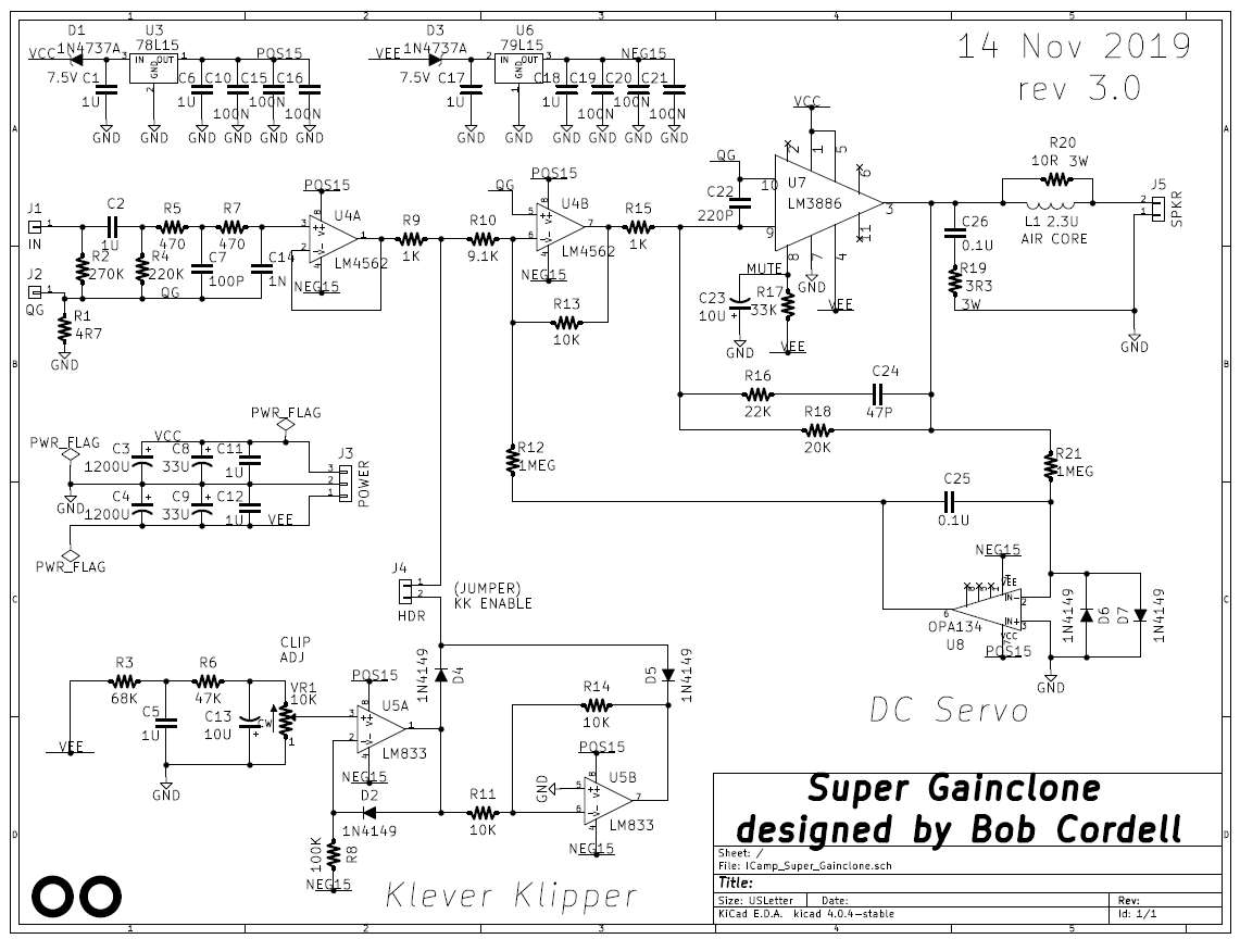

Just for fun exercise here decided to run the schematics in the simulator.

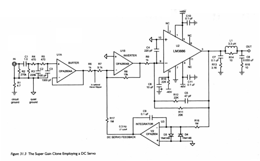

Original Cordell's schematics is attached:

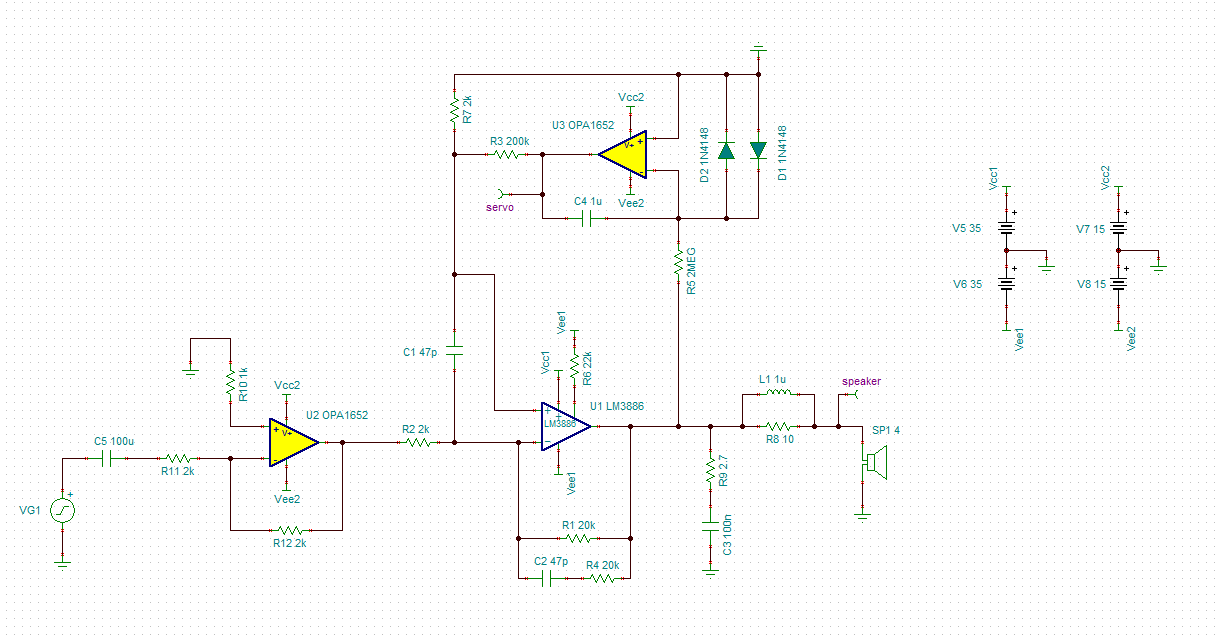

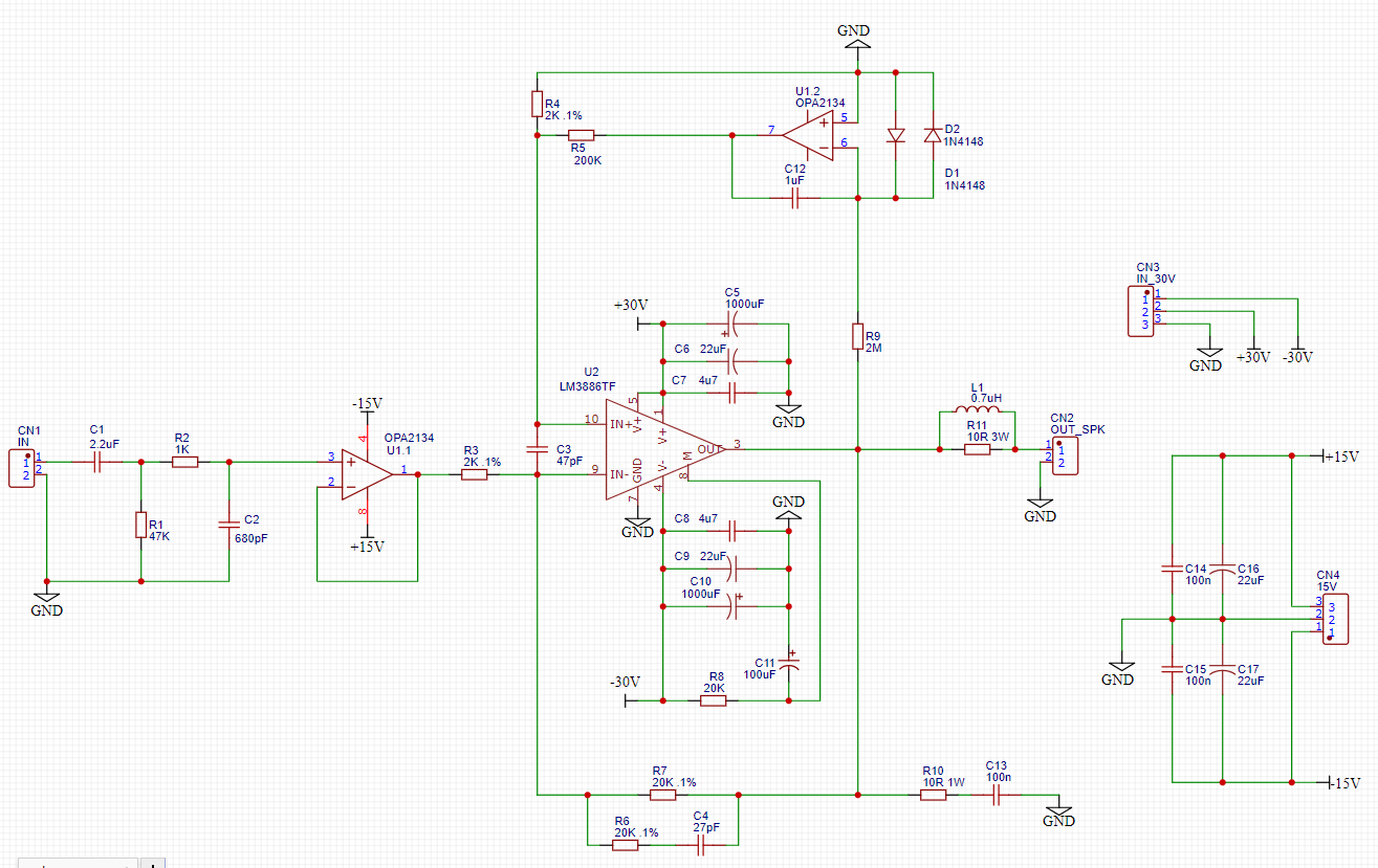

Here is the TI application note schematics for the servo:

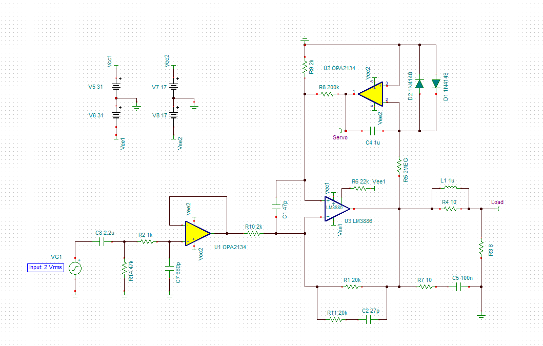

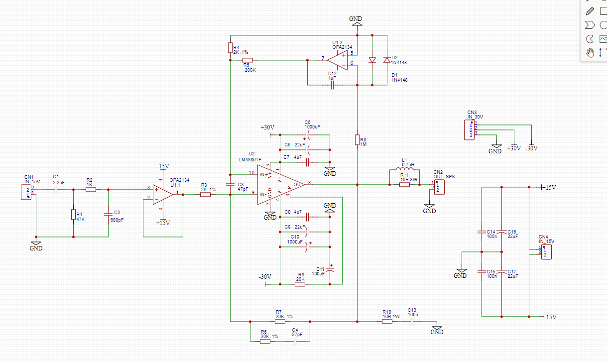

And here is my take on it - drafted in TINA TI simulator:
It is almost the exact copy of the one from the TI application note. Super gain clone has its phase reversed back and so the LM3886 outputs the signal with the same phase it was fed to the input of the first opamp. I did not bother with that additional step in my schematics. It allowed to save on one additional opamp. I am using OPA2134 as I personally listened to it and I like the sound a lot. It also has ah-ok DC precision to work as a servo. Loading OPA2134 with easier load (2K in my case) should produce less distortion - according to the graph in the datasheet.

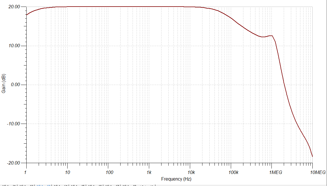

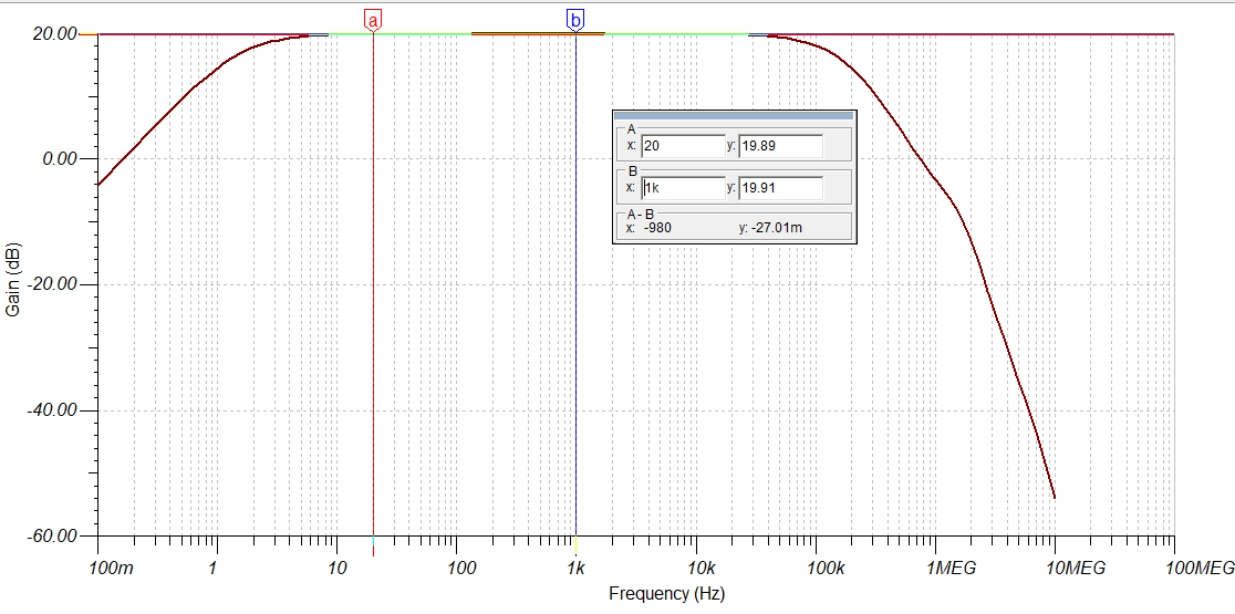

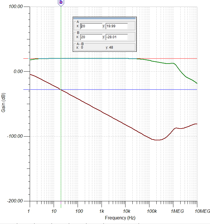

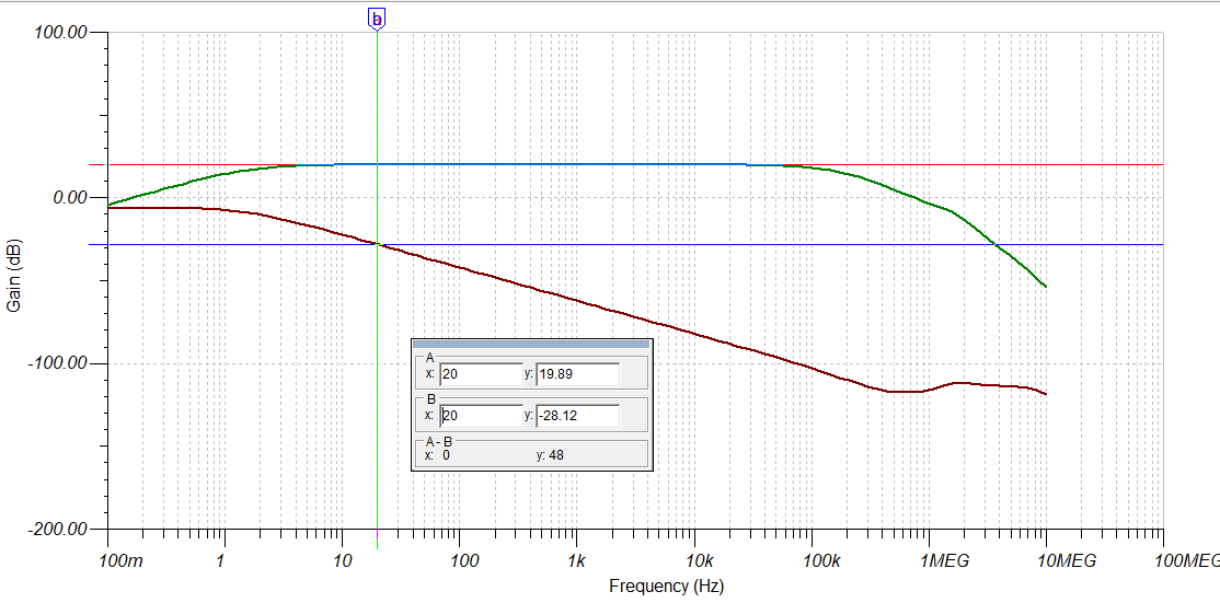

Servo values got adjusted to give difference of 47dB at 20Hz - that is between usable signal and the feedback one:

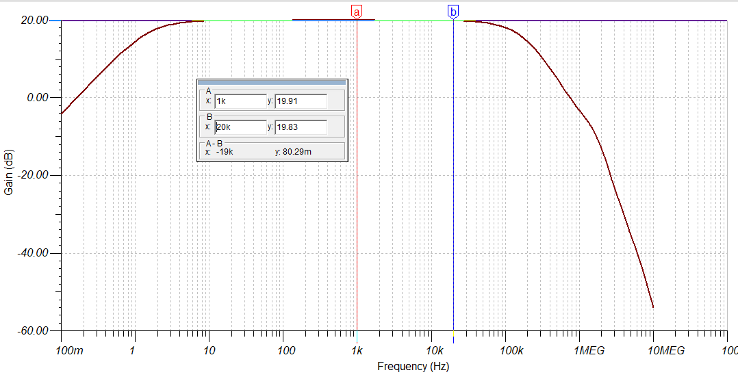

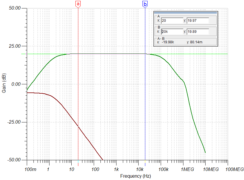

Frequency response is -0.03 dB at 20Hz and -0.11 dB at 20KHz. That is with the gain of 20dB:

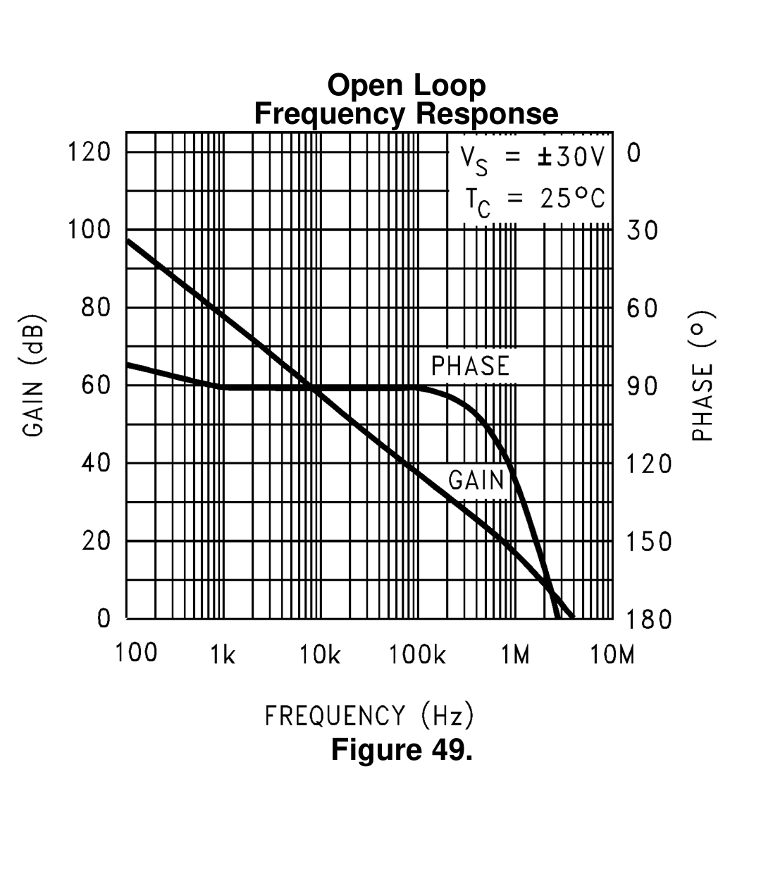

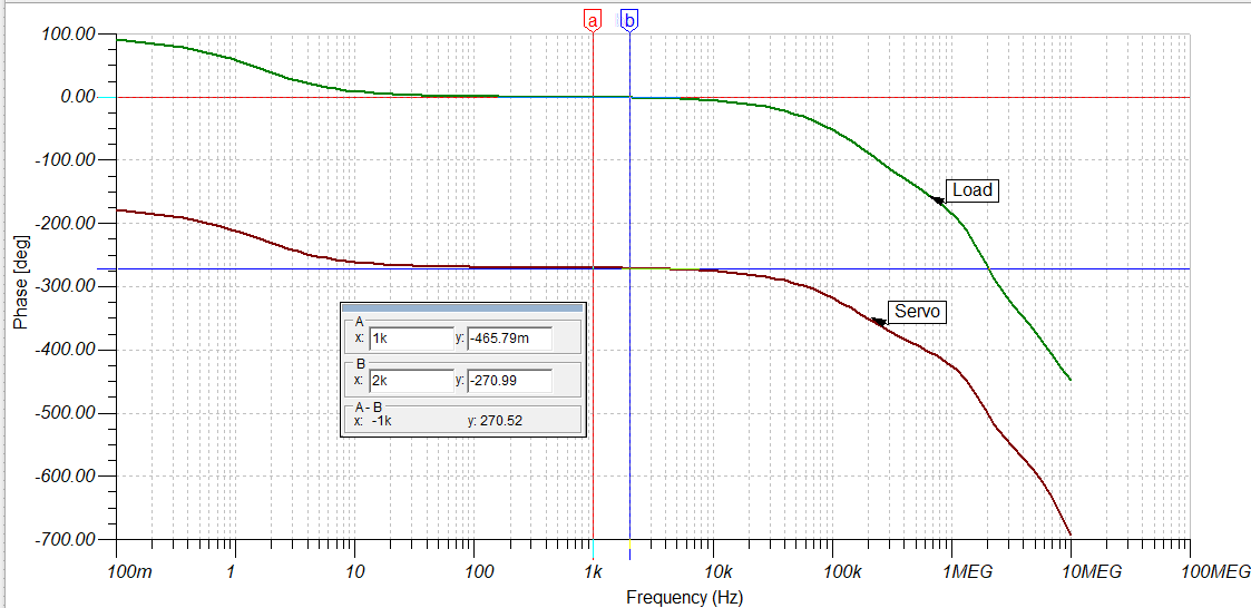

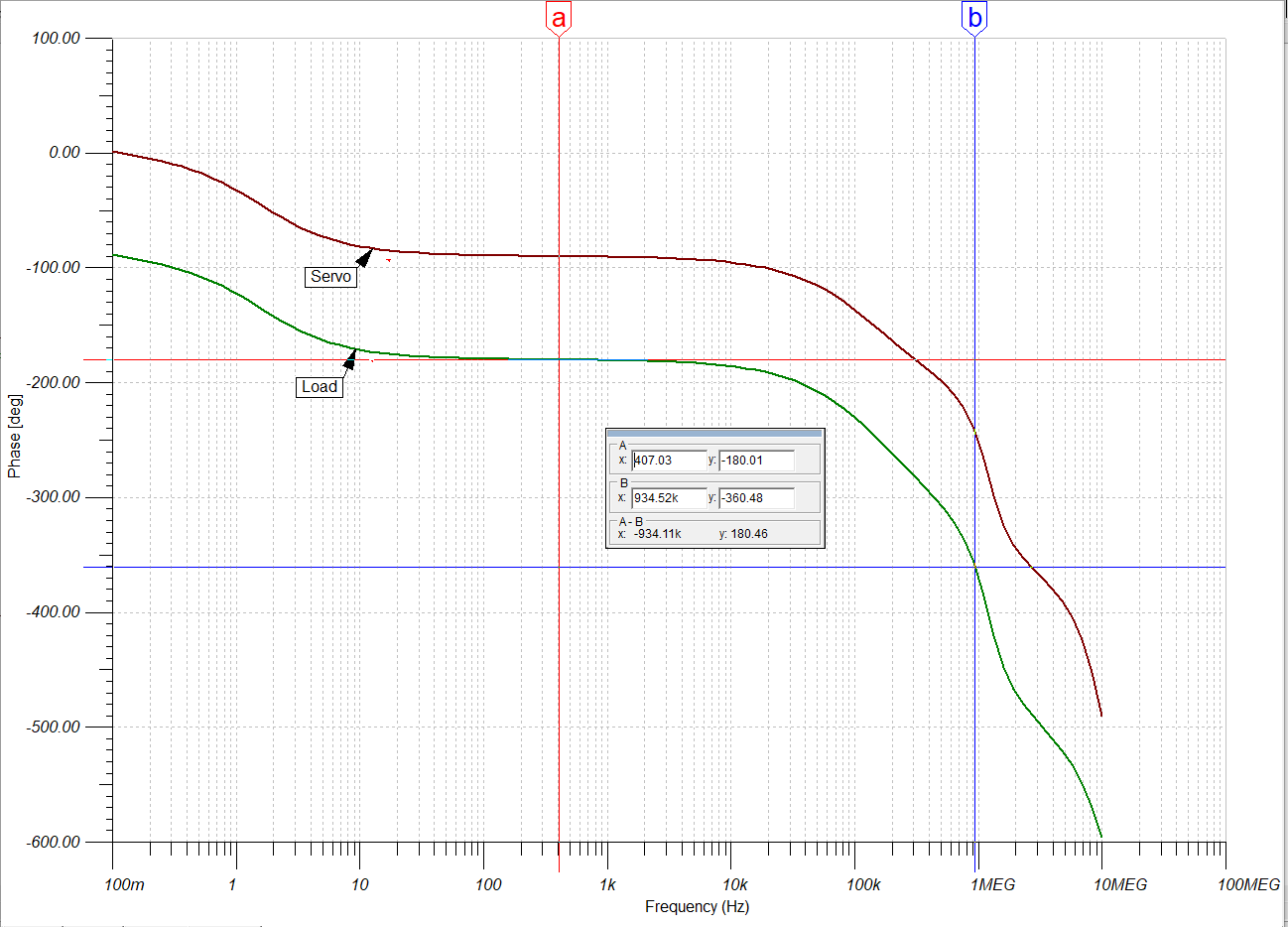

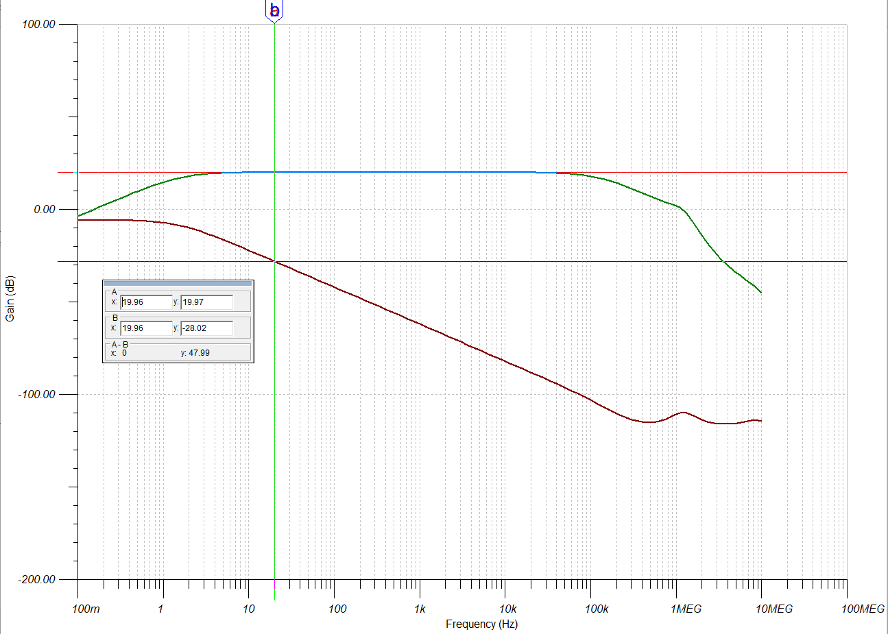

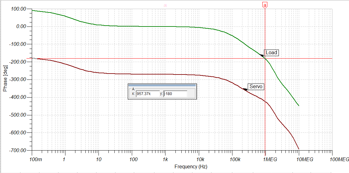

Stability components were added to the schematics to insure proper performance of the LM3886. As far as I understand opamp stability theory - idea is to make sure we are avoiding oscillation condition where the output signal phase is inverted 180 degrees and fed back to the inverting input of the LM3886. With given values for stability components phase is preserved under 180 degrees shift up to 934 KHz and depicted in the graph below:
Comparing that result to the open loop gain graph for LM3886:
At the end I just wanted to mention that I am not an expert in the field and could have made mistakes - therefore I would really appreciate any input on any part of this analysis.
Attached is the zip file with simulation.

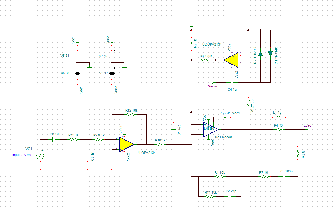

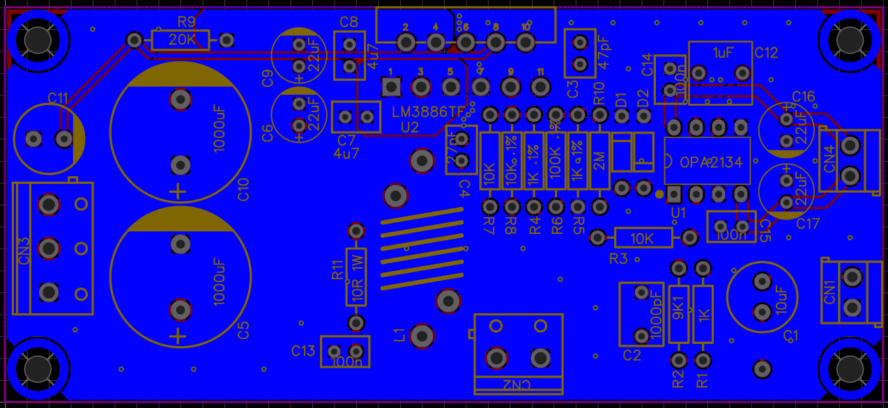

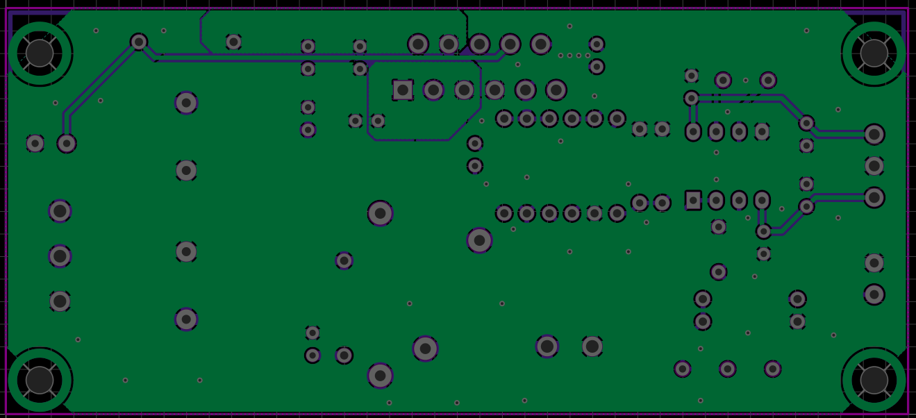

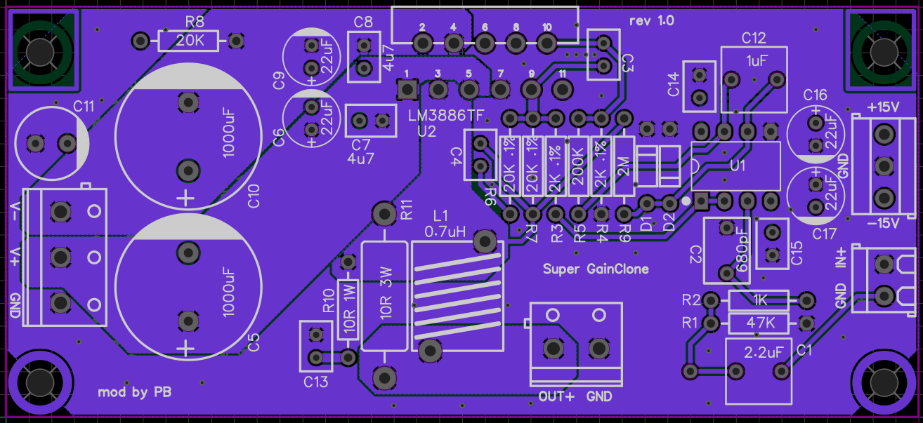

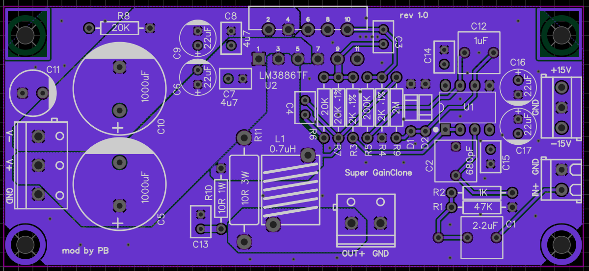

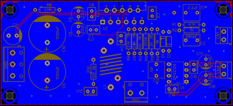

Gereber design for the schematics if someone is interested to build this is attached below:
Preserving phase simulation results and schematics are attached.

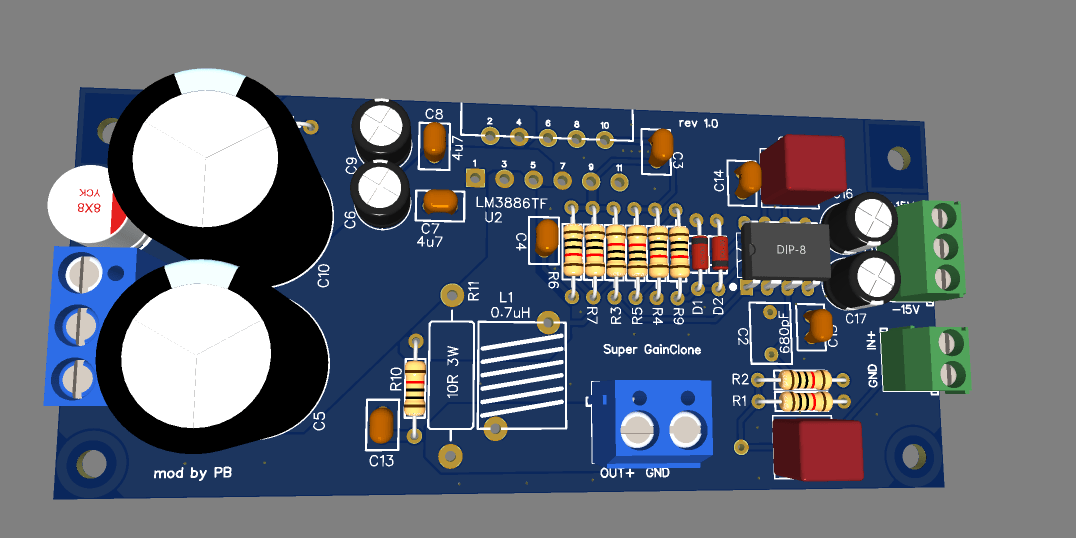

PCB board is attached with this post.
Input capacitor is Nichicon UFG can be found on Mouser - 647-UFG1K100MEM1TD
1000pF capacitor is film type - Mouser # - 871-B32529C102J

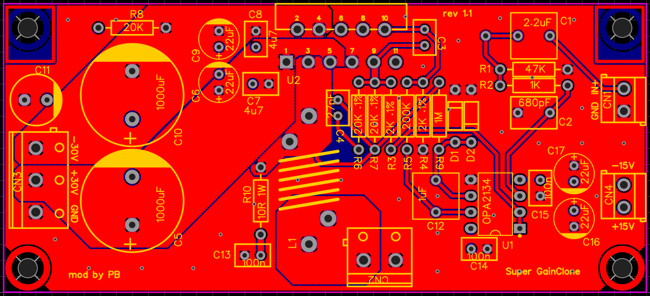

You would do well to follow TI/Nat Semi's advice and value the bypass caps as specified -- 100nF and 10uF
Here's Bob's Super Gain Clone, including his Klever Klipper, as implemented on diyAudio in a Group Buy, Dec 2019. End-to-end it's noninverting. (thread link)

I just followed advice from this article - https://neurochrome.com/pages/supply-decouplingYou would do well to follow TI/Nat Semi's advice and value the bypass caps as specified -- 100nF and 10uF
_
Thanks for linking the thread. It is really nice one to one schematics. I guess I'm just having fun trying to come up with different varieties of the same idea - using LM3886 as inverted to reduce common mode distortion.
You can see a comparison between the LM3886, LM3886 Super GainClone, and LM3886 Super GainClone with Klever Klipper here: https://neurochrome.com/pages/super-gainclone-with-klever-klipper
Tom
Tom
Simulation does not normally model power supply decoupling.You would do well to follow TI/Nat Semi's advice and value the bypass caps as specified -- 100nF and 10uF
Simulation with the LM3886 model included with TINA-TI doesn't model anything power supply related. Not even the load current is reflected in the supply current.

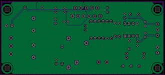

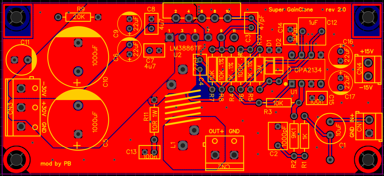

Another revision of the PCB - reorganized few things on the board.
Attached is also TINA-TI simulation file (zipped).
