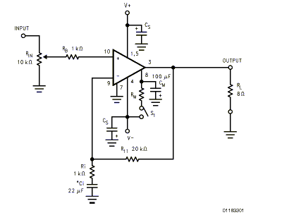

which circuit - which voltages ?
Skyraider,
Which schematics do you mean ?
Is this the datasheet you are talking about:
http://cache.national.com/ds/LM/LM3886.pdf ?
Do you mean the SINGLE supply circuit on page 6 ? I don't see any other.
I am just asking because you mention a transformer with three taps.
You wouldn't have by chance connected both (+ and -) voltage supplies to this circuit ?

sorry, I didnt use the circuit from the LM3886 datasheet, I used this:

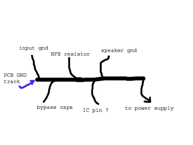

I put all the external components on a veroboard, and soldered everything close together so it is almost p2p. Then I connect it to the chip using wires. I think my problem might be oscillations due to ground loop, as i read the forum further, the veroboard has very small traces (too small for 7 amperes). I used a single ground line and the speaker, input, gain resistor seems to be pluged into the single line. DONT USE THIS METHOD.
I think I am going to use true P2P wiring, and keeping every signal lines ASAP(as short as possible). should be able to finish today. Will post it in the forum if im done.
thanks for the tips guys, Ive finally solved my problems.
The improper ground lines thats causing oscillations. Previously, my old circuit looks like this:
Previously, I wired all the external components to a stripboard, and I connect the chip to the board using wires(about 3 inches long). Ground loops happens because it seems that all the components are plugged into a single earth line, and to make it worse, the line is a very small PCB track.
This morning I took everything apart, I used P2P wiring, and connected all the earth wiring to a star, making it like an ideal sink. I kept all the wires short, and bypass caps as close to the chip as possible LM3886 has been abusing my neighbours for two hours now.
I get lower noise floor than before, and I think I am hearing extra noises from my carbon resistors. from here I understand 2 things:
1) how to identify an amp oscilating.
2) all ground line is best connected to a centre point, making a star shape. For this, P2P wiring is and advantage.
