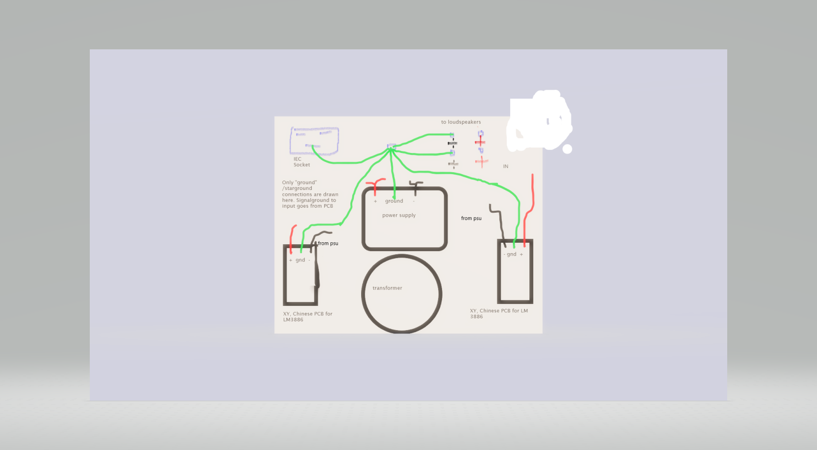

Use a pair of XY pcbs and have a star earth point near the IEC socket. One wire from power supply pcb,one wire from earth on the IEC socket, one wire from the XY amp pcb, and one wire from the minus output. All these wires are connected/bolted to the chassie. But still I have the hum/buzzing in my loudspeakers. Also tried a 100nF capacitor, 10 Ohms resistor, and two diodes connected between chassie earth and PSU earth, but that did not make any difference. I read an article on the internet, somewhere, where there was a discussion about "grounding/earthing" a project where a pair of XY peeceebees were used, but I can not find the article anymore. I like the sound of the LM3886, so that is the reason why I am asking for advice, if the are some other peeceebees out there that are properly built. Thanks a lot for your advice. Appreciate that!!

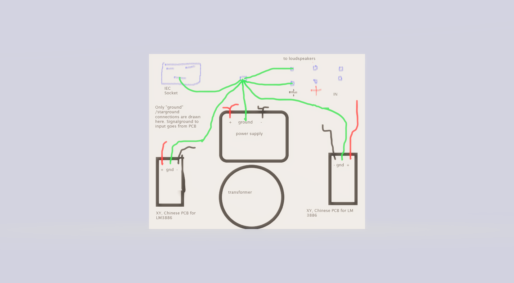

Have not checked the ground connections yet, but here are the drawing around "grounding" my amp. I know that the XY peeceebees are dirt cheap, and that is probably because there are some bad layouts of the ground points on the peeceebee. I have read many articles of how to mod these amps. That is the reason why i was looking for another peeceebees. Maybe the layout are better then on the XY peeceebees? Here is my drawing that shows how the grounding are done.

Are you sure that the speaker connection + and - are connected to GND !!??
please re check and re draw..
The speakers must be connected to the output of the amplifer. + and -

Are the input grounds (RCA sockets) connected to the chassis or isolated?
And as said before, the GND of each PCB is isolated from the chassis?
(aka, not connected via screws)
Other than that, maybe your transformer is very near the input cabling or similar? Post a photo if you don´t mind.

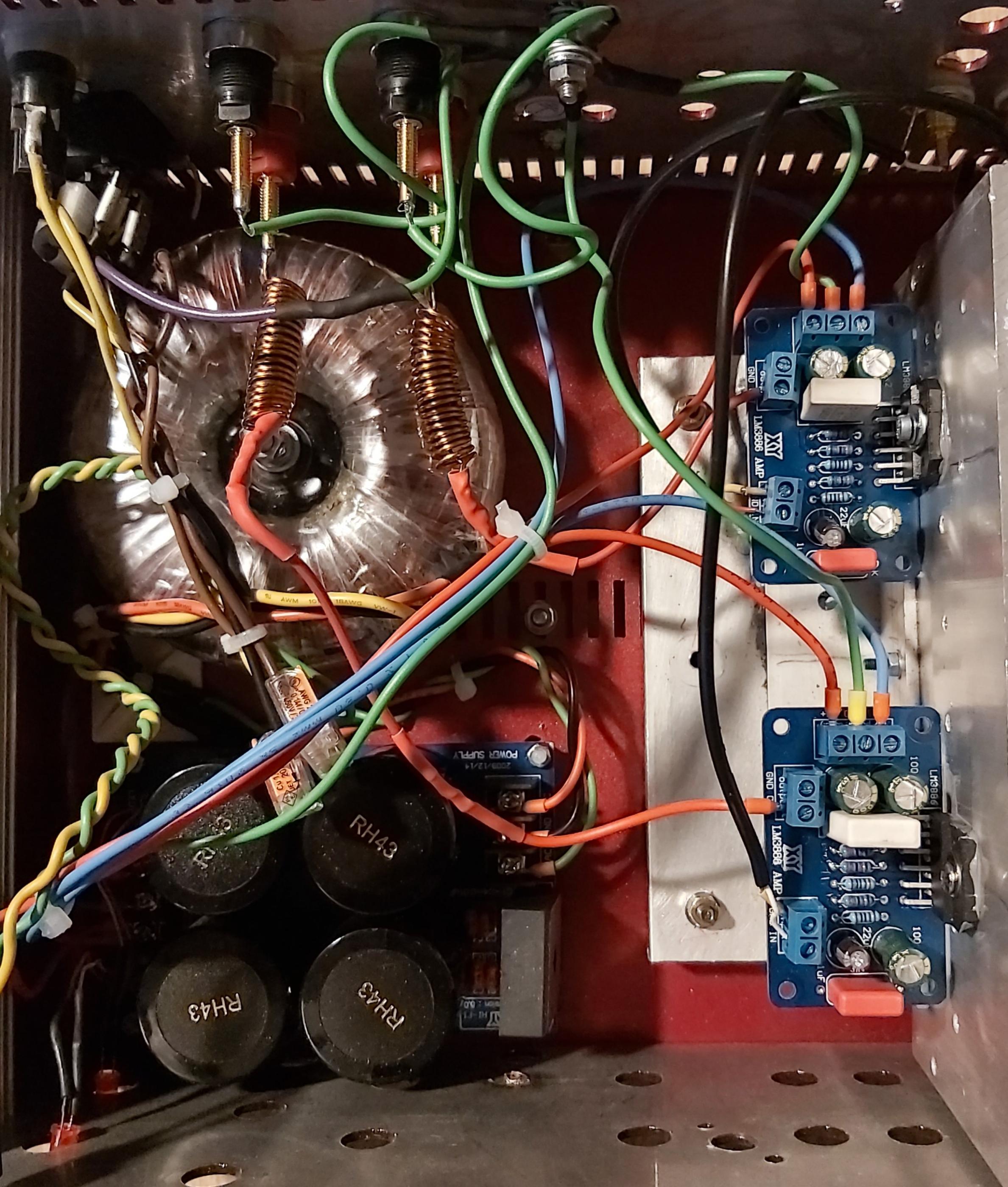

Ah, always good to see what we´re talking about.
You take the speaker (-) from the star ground not from the PCB, right?
I´d try the speaker-GND from the PCB and then make the output a twisted cable. Also I´d try to move the Thiele network (L//R) closer to the PCB.
It could pick up something from the transformer, the way the cables are lead.
The star ground should ideally also be nearer to the PS-capacitors.
But these are all suggestions from not the most experienced here ;-)
