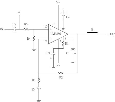

This is first post, I built a dual mono LM3886 with two 300VA transformer and 10000uf/63v cap per rail, the sould is pretty good overall, but everytime when someone mechanical turn on or turn off the light power and sometimes the Refrigerator Compressor also influence , my speaker will have "pia" noise, but this situation not happened for my previous power amp, except this the background is very silence, is anyone experience for this , thanks.

Many thanks you guys suggestion, I will try the RF filter at input RCA socket, but any recommend for the value? how about 680 ohm +470pF

Actually I tried many power amp(none chip), only this Lm3886 have this problem, so I think may be the chip amp is more sensitive for power or environment, next action maybe I will add a regulated power supply(use LT1083), I have no idea is this work?
Don't regulate.
Attenuate the interference.
Fit an RF filter at the input of the chipamp.
Consider adding a filter direct across the RCA input sockets.

Thanks all of your comments, I prepared the parts for RC filter will install tonight, I will update the result.
download the data sheet
Look at their example schematic...you'll see that you're missing a cap across the feedback resistor, as well as the cap pointed out by Piggy as missing.
more missing
you are also missing the zobel network...your pinging is because the amp is not really stable without the mentioned components.
I add the 220pf cap across pin9 and pin10 and also add zobel network, seems to hit the problem, the noise is completely gone, but I didn't know which change take effect, anyway thanks all of you provide so many ideas.
