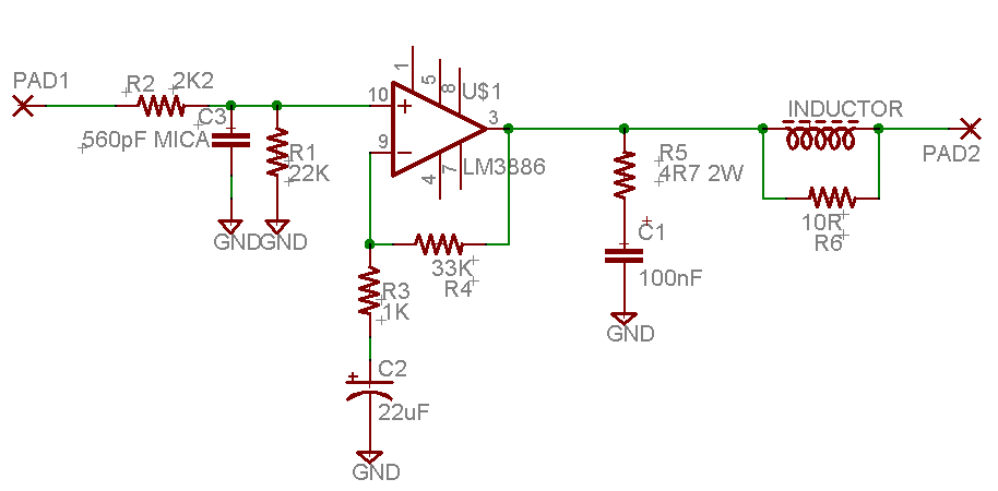

First, it doesn't have input decoupling capacitor, and there's nothing to protect the amp against nasty oscilations coming trought the cables.
Althought it have the inductor + resistor protection, it don't have much protection as it is missing the RC output filter. It use to be 4R7 + 100nF.
input Impedance is determined by the POT, and this is not good, as if the pot start to make noise, the amp can blow.
That's why its a bad implementation.
I've drawn quickly a little schematic, it's missing the power supply bypass caps, and mute function, but you can see what I'm talking about.
An oscilating amp gets hot, sounds fool, and is likely to blow. This is MUCH more safe.

thank you nando 🙂 . i will do your mods. i wasn't planing to use a pot for the volume but to solve it somehow from the preamp.
can i ask you about the decoupling cap in the input, would it effect the bass freqs? and also i understand it should be in series with the resistor and not connected to the ground?
i dont know too much about the tda7293 chip, i chose the lm3886 because there seems to be alot of info about it on the web.
one last question, what kind of power supply should i be useing?
thank you very much for your help 🙂
