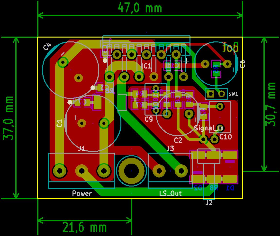

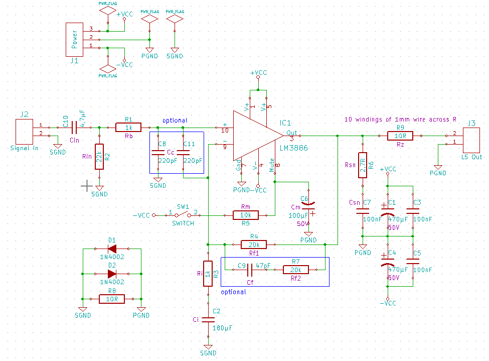

Here is what I have done until now.
The schematics is still a bit messy, because I have changed it several times after studying several design "guidelines".
The color codes for the layout are:
Red: top copper layer
Green: bottom copper layer
Cyan: top silkscreen layer
Magenta: bottom silkscreen layer
The parts were selected from the available types at Conrad and Reichelt, two popular german parts suppliers.
They may still change, but here is what was used for creating the current layout:
Cs (C1, C4): Panasonic FR 470µF 50V; (C3, C5): ceramic X7R 100nF
Ci (C2): Panasonic FC 180µF 50V
Cin (C10): Wima MKS-2 4.7µF
Cm (C6): Panasonic FC 100µF 50V
Cc (C8, C11): ceramic NPO 220pF
Cf (C9): ceramic NPO 47pF
Csn (C7): ceramic X7R 100nF
Rsn (R6): Yageo RC1206 2.7R 0.25W
Output resistor+coil (R9): will be removed from PCB
other resistors: metal film 0805
What do you think of my attempt?

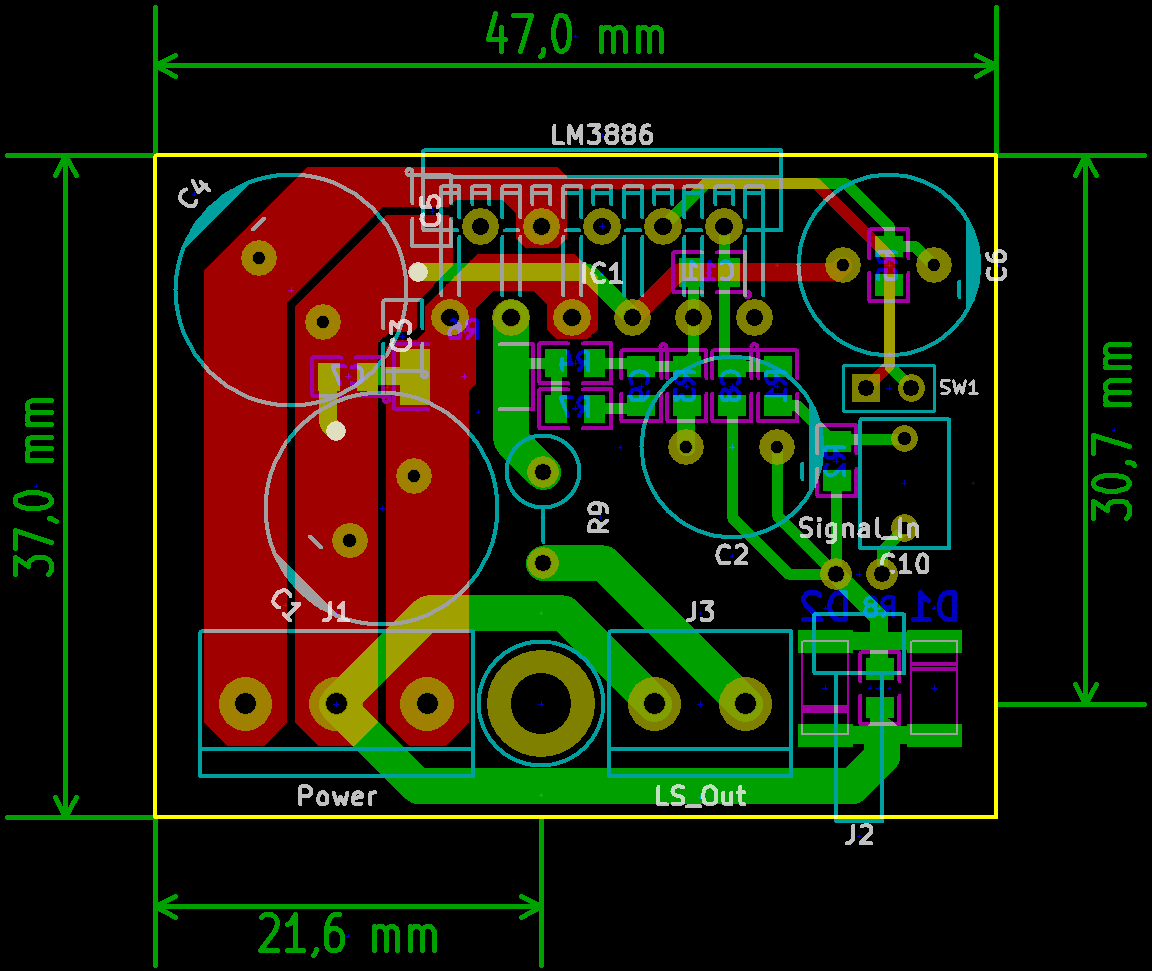

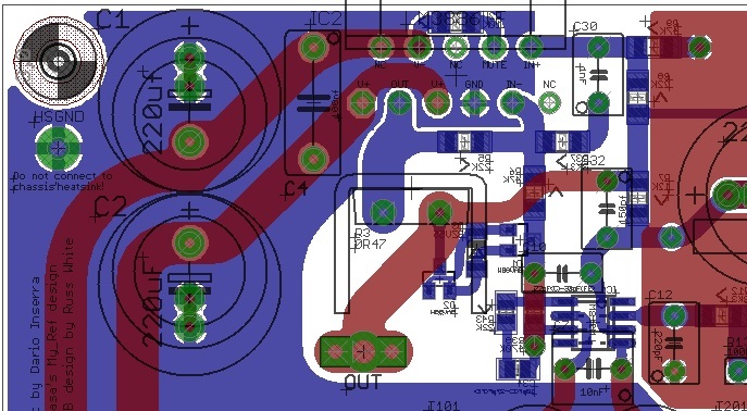

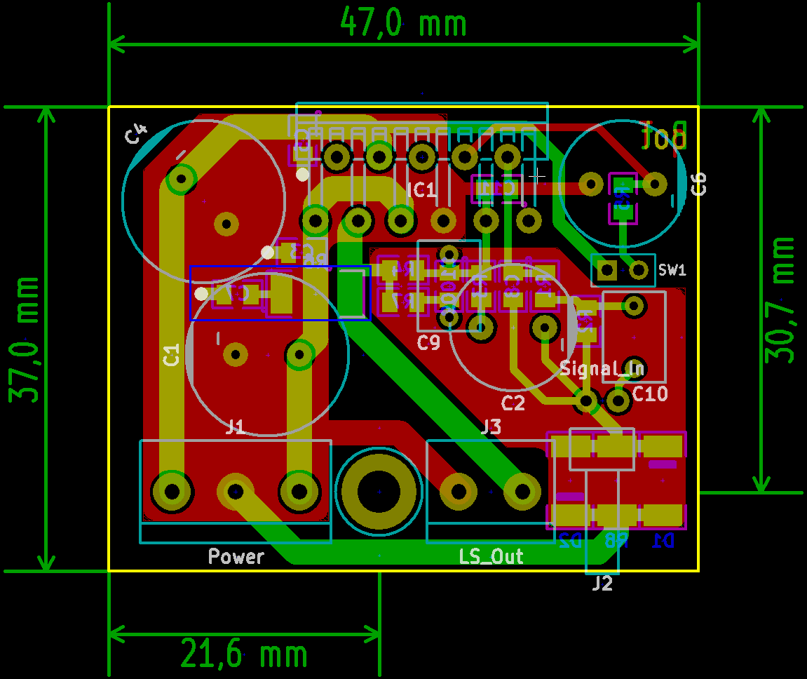

I would trasnfer PGND to the other side or to a groundplane so that you can route differently several traces like the ones related to mute pin and V+.
Something like that:
As you can see V+ doesn't overlap OUT 😉

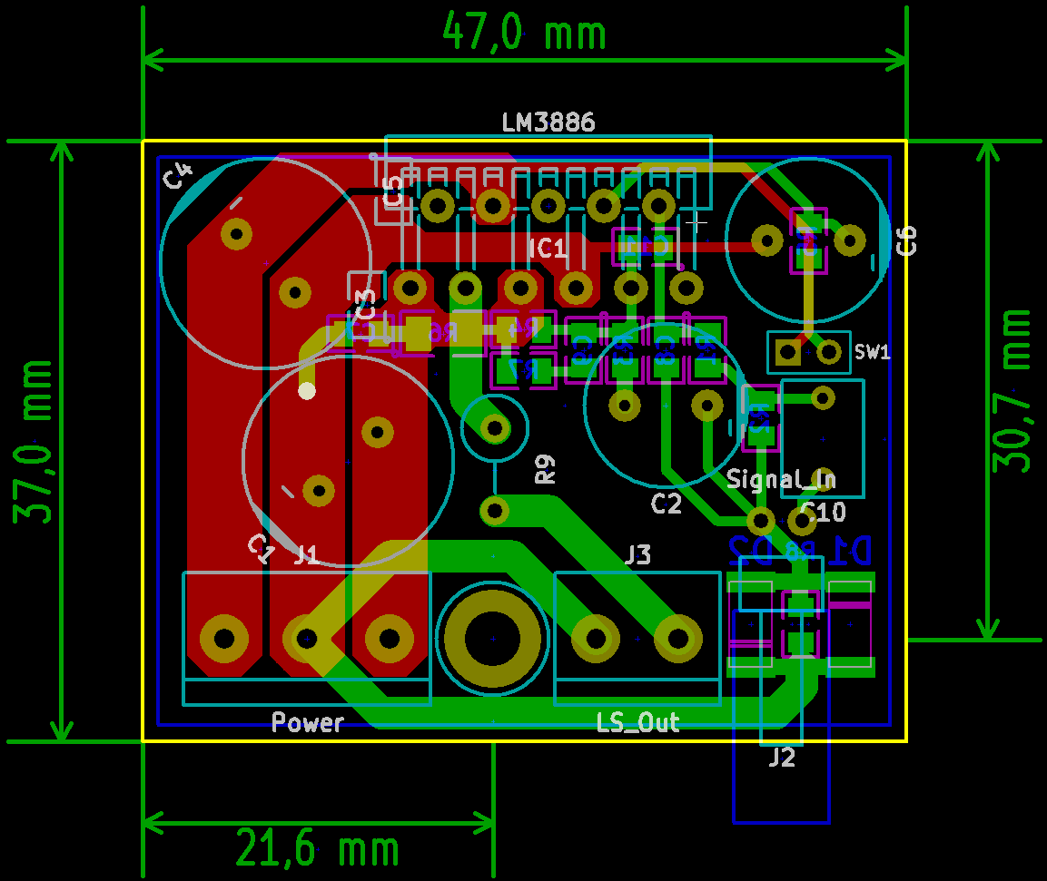

I have left them intentionally on the same side, because of the SMD bypass caps I use at the moment.I would trasnfer PGND to the other side or to a groundplane so that you can route differently several traces like the ones related to mute pin and V+.
But I could trim the ground polygon under the IC, and place the V+ track under the IC (where the ground trace is at the moment).
How would that be?
I don't like the crossing of V+ and Output either.
But sometimes I need to get a hint from someone else to see a solution.
You can use vias... or use LM3886 pads as vias...or simply bypass rail to rail like I did...
How would that be?
Post a picture...
The V+ trace would just look like yours, and Gnd trace would end between the SMD decoupling capacitors.You can use vias... or use LM3886 pads as vias...or simply bypass rail to rail like I did...
Post a picture...

Here's my new approach for the power supply routing.
Better? Worse?
Somehow I'm not quite sure if I like it or not...

I have redesigned the power supply bypassing again.
It now looks a bit more like the screenshot from ClaveFremen, thanks again for the pic! 🙂
I have also added a ground plane for Signal Ground, which only connects at the signal ground star point (located at the NF input).
What do you think about it?
Regards, Stefan
Regards, Stefan
Way is your plans for the power supply? Consideration of how you will power your LM3886 chip modules you are building here is probably as important as anything else you are working on here. CarlosFM's snubberized PSU design is as popular as they get around here...I personally prefer the regulated supply he designed, either one is an excellent choice.
Yes, the output Zobel is located under C1.is there an output Zobel fitted?
A MELF resistor connecting at the output trace and crossing the V+ trace, and a 0805 capacitor.
I have marked it (blue rectangle) in the attached picture.
Is the placement ok?
I moved down the row of SMD parts for about 1.4mm, to make room for an alternative footprint for C9 (Cf).The HF decoupling route looks as though it is a bit longer.
Stupidly, I didn't find any SMD capacitors in the 50pF range other than ceramics (C0G or NPO).
So, if I want to use a foil type for Cf, I will have to pick a THT part.
But I could move the other parts back upwards, where they were before.
Would that be better?
You're welcome, Stefan 😉
Maybe you could separate signal ground from powerground with a low value resistor (1-10 Ohm).
Andrew, what do you think about it?
Sincerely I don't like it much... you can possibly pollute PS lines with amp's output...
The zobel, IMHO, should go away from the groundplane.
Also try to isolate LM3886's OUT from groundplane (same reason).

The two grounds are already separated by a resistor (R8) and two anti-parallel diodes (D1, D2). The connection point is located in the lower right corner, right from the output terminal, and under the input connector.Maybe you could separate signal ground from powerground with a low value resistor (1-10 Ohm).
Interesting, as I think about it, I'm more concerned about the Zobel resistor picking up noise from the V+ trace and leading it back to the feedback input.Sincerely I don't like it much... you can possibly pollute PS lines with amp's output...
What about if I rotate the Zobel by 90°, so that it would go downwards instead of left?The zobel, IMHO, should go away from the groundplane.
Ok, I will cut the plane over the output trace.Also try to isolate LM3886's OUT from groundplane (same reason).
