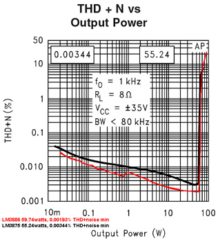

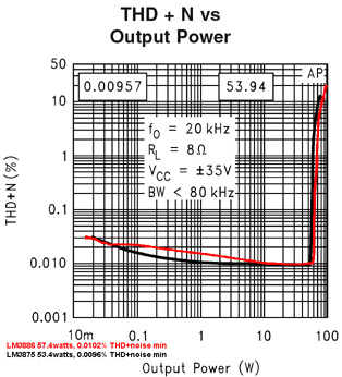

LM3886 better in most ways
The 3875 is better in input refered noise by 2.5dB
(-115.8dB vs -113.3dB at 60W into 8ohm)
Because of this the 3875 also has slightly lower THD+noise at low power 20kHz.
However, the actual Harmonic Distortion of the 3886 is lower by about 3dB at most frequency and output power combinations.
So the 3875 is lower noise and the 3886 is lower distortion.
IMO they both already have very low noise and noise is far less irritating than harmonic distortion. So I would consider the 3886 as superior in sonic terms.
The 3886 also puts out more power for any given load or supply voltage,
At 35 volt rails and 8 ohm load:
the 3886 typically puts out ~60Watts
the 3875 typically puts out ~56Watts
As already mentioned the 3886 has the current capability to handle 4ohm loads more efficiently.

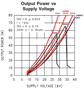

I've wondered about the THD+N comparisons that have been used when comparing these two chips.
The fine print in the data sheets indicates that the 3886 was tested at Vcc=+/- 28v and the 3875 was tested at Vcc=+/- 35v. Also, some of the 3886 measurments used 4 ohm loads vs. 8 ohm load for the 3875.
Will some of these differences effect the THD+N measurements??

Its good to see someone that actually reads the FAQ and spec sheets, not just glance at the 68watts..............
The LM3875 all tested at +/- 35VDC
56watts into 8 ohm load .1%THD
signal to noise ratio greater or equal to 95db 2.0uv noise floor
typical IMD (SMPTE} .004%
THD+N .06%
The LM3886
68watts into 4ohms at +/- 28VDC supply at .1%THD
38watts into 8ohms at +/- 28VDC supply at .1%THD
50watts into 8ohms at +/- 35VDC supply at .1%THD
signal to noise ratio greater or equal to 92db 2.0uv noise floor
typical IMD {SMPTE) .004%
THD+N .03%
So the 3875 puts out 6 watts more at +/-35 as does the 3886 less power I think not
same distortion levels
signal to noise ratio is better 95db to 92db
If you look at the peak current curves are better by .78 amps at the same voltage.
and yes the THD+N is at 28VDC for the 3886 and 35VDC for th 3875.
As for sound quality IMHO the 3875 kicks #$#$#@
and the 3875 is much better for BPA apps when it is doubled up it handles much higher peak outputs almost 20%.

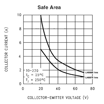

Graphs frpom national data
This graph shows the safe operating area of the LM3886 and 3875 for 1 millisecond.
It shows that the LM3886 has a much greater peak power dissipation capacity at the output transistors and demonstrates that this amp is much more rugged.
