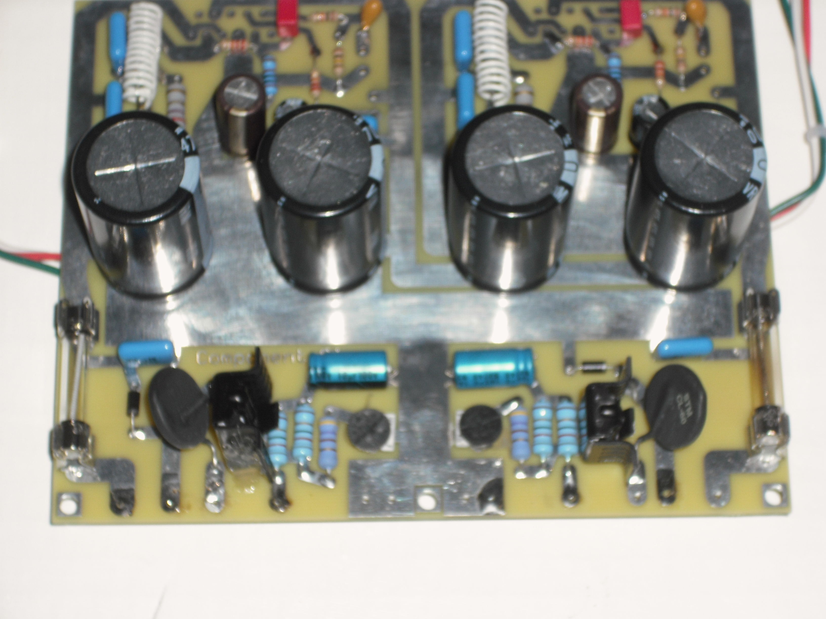

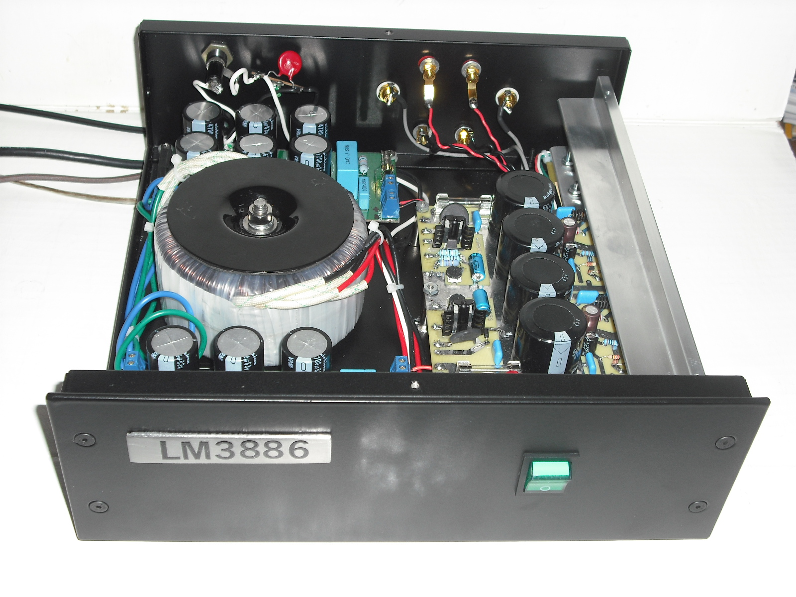

Mouser have it for $1.30. Also you can buy it in different current rating. The CL30 is 8 amps. Also to prevent the spikes in the powered up I use a GE GMOV V130LA10A across the transformer primary winding to prevent the spikes. The prices for the GMOV in mouser is 30 cents. I used both in every electronic equipment that I built or repair. They really worked.
Attached are two pictures of my LM3886 showing the LMR installed in the board.
