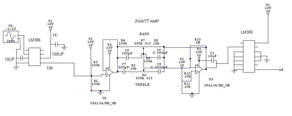

lm380 2watt amp
have trouble at the point were the treble bass section meets
the lm380 singal does come out be its very low

Hi seanmacss,
Tell me that your +10V is not connected to the inverting input of the op amp driving the LM380. The output also has an AC short to the positive supply through C1 (goes to ground and +10V, right?).
I haven't seen a tone control with C6 and C8 in those positions, try removing them.
Why no output coupling cap???
Absolutely! Not unless you need to bias that input to 1/2 Vcc from an external source, then what you are doing is fine.
-Chris
