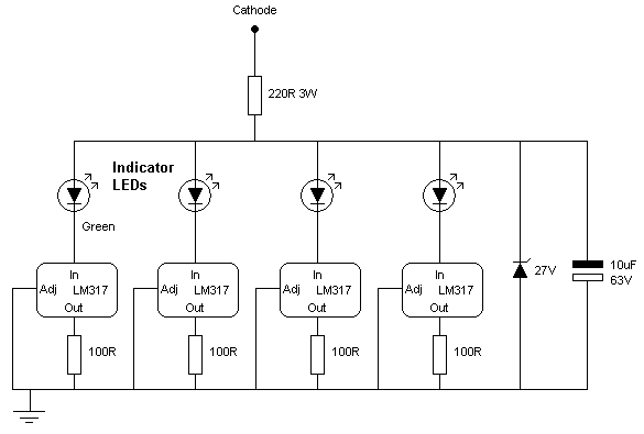

I have a simple LM317 CCS circuit in the cathodes of my output tubes - it seems to work well, apart from a millivolt level oscillation problem I discovered on my scope. Attached is the circuit. It seems to be oscillating into the Mhz region, I can't remember which scale I had the scope on, but it was near the limits of my 20Mhz bandwidth. The amplitude of the oscillation is about 20mV.
Each LM317 is programmed for 12.5mA, which may actually be too low. My decoupling capacitor is a 1uF electrolytic (not 10uF like in the schematic, sorry about that), which may be the problem too.
Perhaps the problem could be solved with a smaller ceramic type decoupling capacitor?
I have attached the circuit

That's because you can't really use 317's like that. They need voltage across them to work properly.
I suggest a "real" CCS, unless you want to toss in a -V supply to make the 317's work right.

Oh well they do have about 7V across them - the 220R resistor is just there to drop some of the voltage. Surely an LM317 is OK with drawing 12.5mA over 7V?
What I did notice when poking around - if I touched the cases of SOME of the ICs - but not all - the amplitude of the oscillation increased. The cases is Vout on these regulators. Maybe the output 100R resistor needs bypassing?

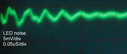

I observed a little noise from my LED referenced CCS. Zooming in on the scope I got this image. Seems similart to what is described here.

Sounds as if there might be a bit of radio pickup since you are an excellent radio antenna and you increase the oscillation. Try replacing the LED's with 10R resistors right on the pins.
You can modulate any diode, certainly a clear one, with light from a fluorescent --- but the period is too short for this to be the case.
You can also get some ringing from the interaction of the rectifier diodes and transformer leakage inductance -- if it's frequency is high enough it will transmit just like a short-wave signal.

Clipping a 100nF capacitor from the output pin to ground seems to cure it! I guess the LM317 likes to see a slightly capacitive load, and the data sheet does warn of a small range of capacitances where they become unstable. The suggestion is to load it with a small capacitor to swamp this! Other datasheets say that the LM317 is stable with no output capacitor 😕
