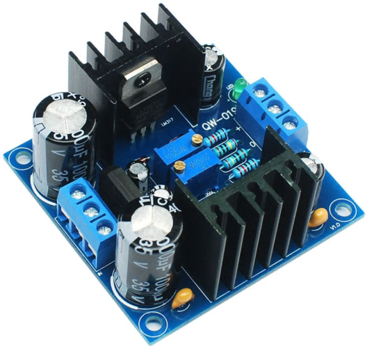

Just built this simple board from China. For testing it's connected to a 12 VAC transformer on one of the AC connections and ground. I set the regulators for +12V (LM317) and -12V (LM337). This works fine.
I guess this board is supposed to be used with a transformer having two 12 volt windings (or a 24 Volt transformer with a center tap). Is (2x) 12VAC enough to get a stable +/-12VDC or should I use a transformer with a higher secundary voltage?
Can anyone confirm this please?
Regards, Gerrit

Hi Gerrit,
It depends on how hard you load the transformer. If not too hard, 2x12Vac will do. If you haven't bought the transformer yet and will load it close to the nominal current, consider 2x15Vac.
Hi FaixFrench,
I may have a load up to 500 mA. Will 2 x 15 Vac be better for regulation? The transformer will be 1 A minimum for each winding).
Regards, Gerrit
Hi Gerrit,
2x15Vac will leave you more voltage margin but (unfortunately) also increase heating (voltage drop times the load current) in the regulators.
An LM337 saturates at around 2V from input to output with 500mA current. To leave some margin you often calculate with 3V. Then, 12V at the output becomes 15V at the input.
12Vac rectified is some 16-16.5Vdc when rectified.
15Vac rectified is some 20V-21Vdc when rectified.
Both the 16.5Vdc and the 21Vdc will drop when loaded. On top of that, you have a load current dependent voltage ripple on the storage capacitor and have to take net voltage variations into account.
I would go for 2x15Vac as I am afraid that 2x12Vac will be too marginal.
