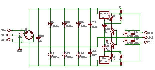

Thats pretty close to what I settled on...
Waiting for some better quality phillips caps from the UK... So I may still remove a few, but these have been added one at a time with proper listenig using headphones.... life would be so much better with a scope, but your ears are pretty usefull too...

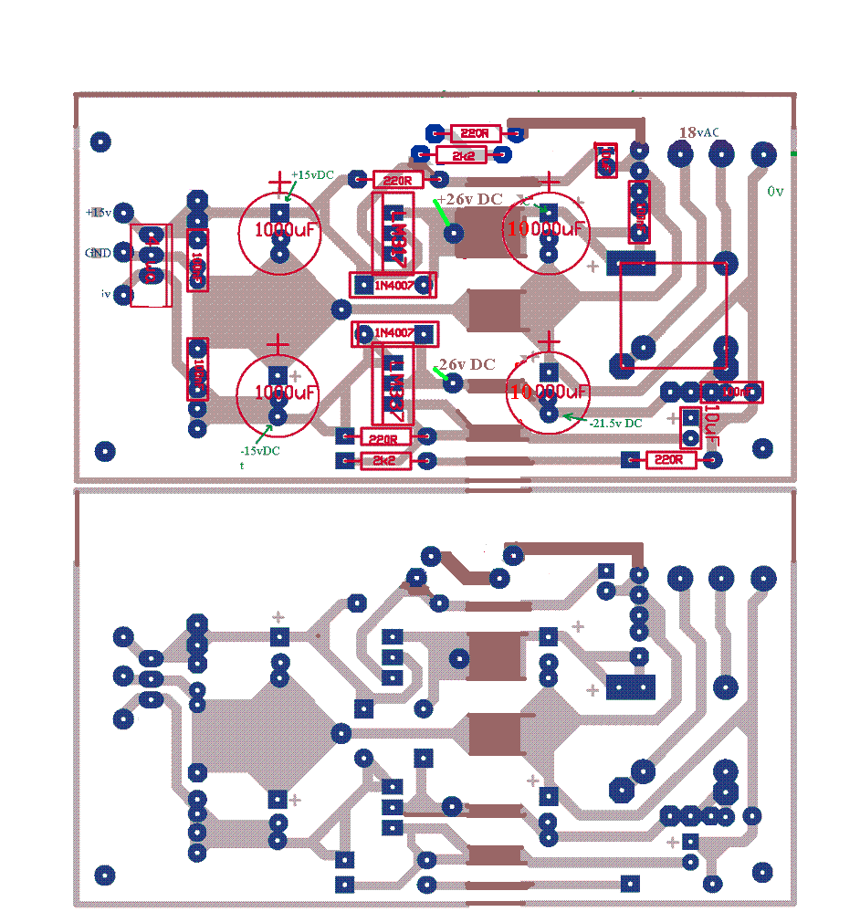

I use this PSU that deliver a regulated +/-15v and an Unregulated 26v (depending on the Transformer used)....
It has worked well for me .....
sorry if it looks a Bit sloppy...
