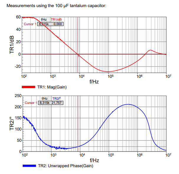

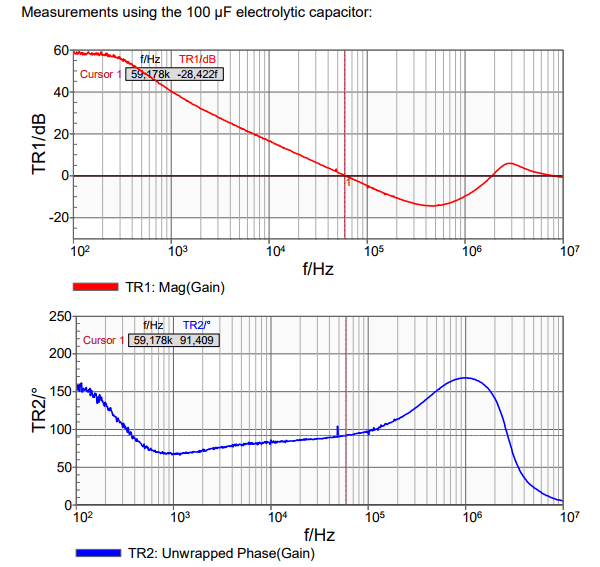

Stability of the LM317 is a function of the output capacitor value (and its ESR) AND the load being drawn. Below a few hundred mA you need a much higher value. Both the OnSemi and TexInstruments datasheets don't mention this, but it is easily demonstrated. (The TexInstruments data sheet graph on the effect of Cadj is also incorrect.)100nf input capacitor and 1uF output capacitor according to datasheet.

Graphs below are from Omicron Labs, demonstrate stability under light DC load (25mA)
According to late analog great Bob Pease; 10uf as CAdj & a general purpose 47-100uf electro at output works best with lm3xx.
