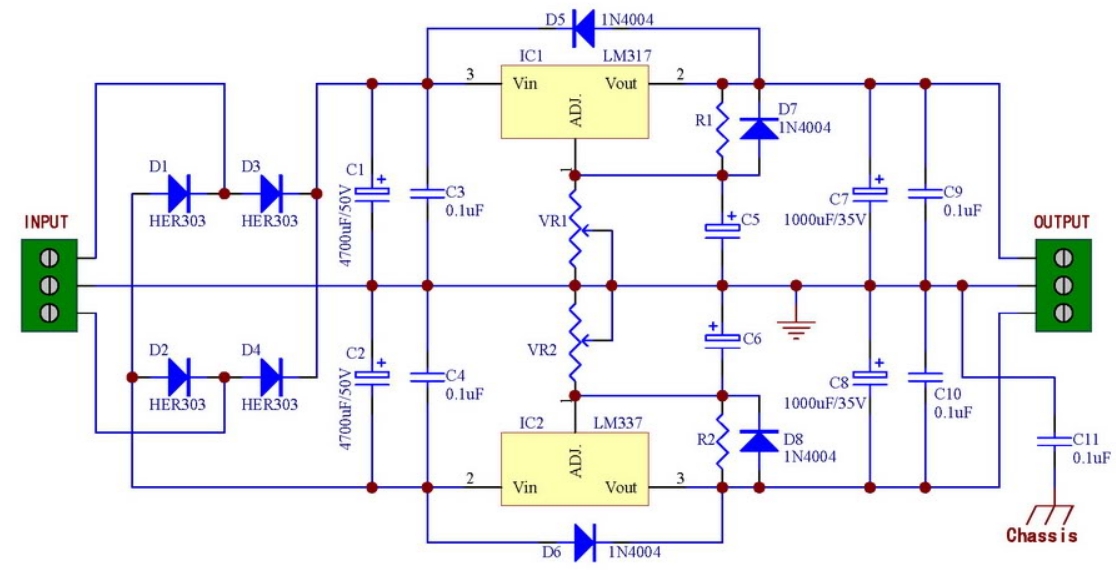

I have a couple of questions about the LM317/337 schematic below that I found on eBay.
1) Are the large HER303 3A diodes really needed for operation below say 200-330mA or will 2A MUR220s work just as well?
2) The circuit shows 1KuF caps(C7 and C8) near the outputs.
Typically, I see much smaller values used in these locations.
Will the 1KuF caps cause any type of ringing or other issues vs. using 100uF or 220uf caps?
Thank you!

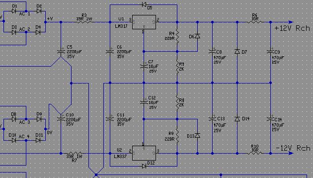

I don't find putting big output caps on LM317s makes any improvement in SQ, often makes it worse. Perhaps due to reduced stability of the reg - though that depends on the ESR of the cap to a large degree. I think TNT audio had a plot of inducing a resonance at HF by having a too-large output cap. I use large output caps but only after an inductor for HF isolation.
If I were using this circuit myself I'd include RC filtering at the input to the regs as their performance at HF is very lack-lustre. On the diodes, no you don't need 3A types.
Putting large caps directly on the output of a regulator is daft for two reasons:
1. other things being equal, the caps will have most effect in exactly the same frequency range where the regulator has most effect - so you are 'solving' a non-existent problem;
2. other things are not equal, most regs have an inductive output impedance so you are encouraging a resonance which will raise output impedance and noise - which is generally the opposite of the reason you had a reg.
If you insist on ignoring the reg datasheet then at least make sure you use a high ESR cap so it does little harm.

1N4002 are adequate for an amp or so. Throw away C7 and C8, they are of no use and will stop the LM regulators regulating correctly due to lag in the response. C5 and C6 should be no higher in value than 100nF, preferable don't use them as the feedback for the regulator will not respond properly and it may oscillate and become unstable.
Look and read the data sheets!
Throwing C7 and C8 may be a bit too drastic. The remaining 0.1uF mag be too low for stability. A few dozen uF would probably be a good idea.

I did look at the datasheets, but they didn't coincide with the above schematic.
Datasheet applications are usually a safe guide to using a particular device but not necessarily the best application.
That's why I'm looking for suggestions from people here who have actually used these regulators and may have experimented with different value caps after the regulators.
As for diodes, I have lots of Motorola 1N4004s so I'll use them.
I'm not going to "throw away" C7 and C8 since even the datasheet shows to use a value as low as 1uF.
I'll use 22uF or 33uF, as suggested by jan, instead of 1KuF.
Per your suggestion, I will leave C5 and C6 off the board.
By the way, are C9 and C10 really needed?

C9 and C10 can upset the stability, especially if they are very low loss. I'd chuck them and instead put them close to the load, they will help there.

I don't agree with all of the above replies. Post8 is correct.
I find that cheap ordinary esr electrolytics on the output are good enough and don't degrade regulation.
I also use ordinary esr electrolytics across the lower resistor (VR1). You already have the protection diode to discharge this and specifically required when a high value electro is used.
C3 & C9 should be close to the reg leadouts. But do not use low ESR film capacitors.
But move your Zero Volts tapping points for the various component connections.
Spreading them out is not the best way to get good performance. Today a revived old Thread shows the correct way to do this.

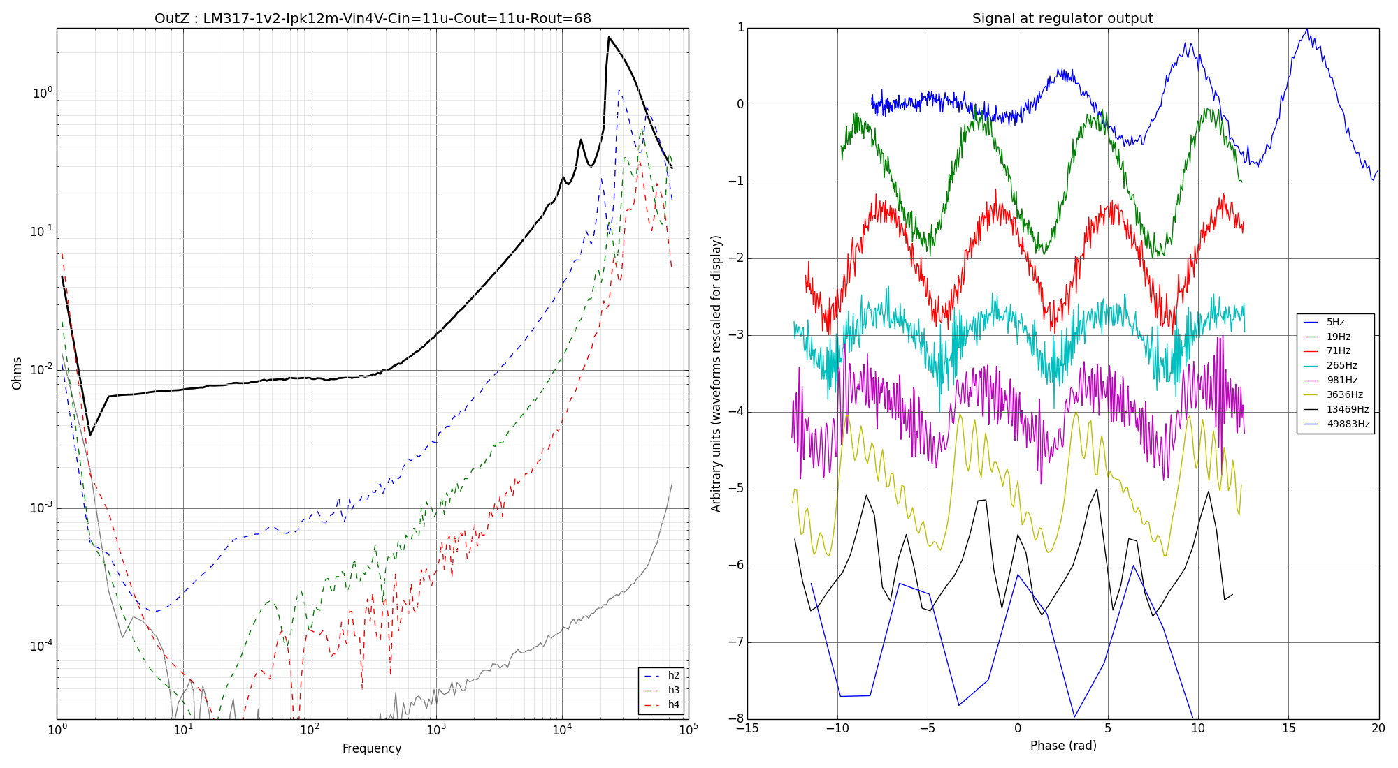

This is an output impedance measurement of LM317 used as 1V2 regulator with one 10µF X7R cap on the output. As you can see from the huge spike in the impedance graph (left, black) it does not work at all 😀
I don't remember which manufacturer this was from.
