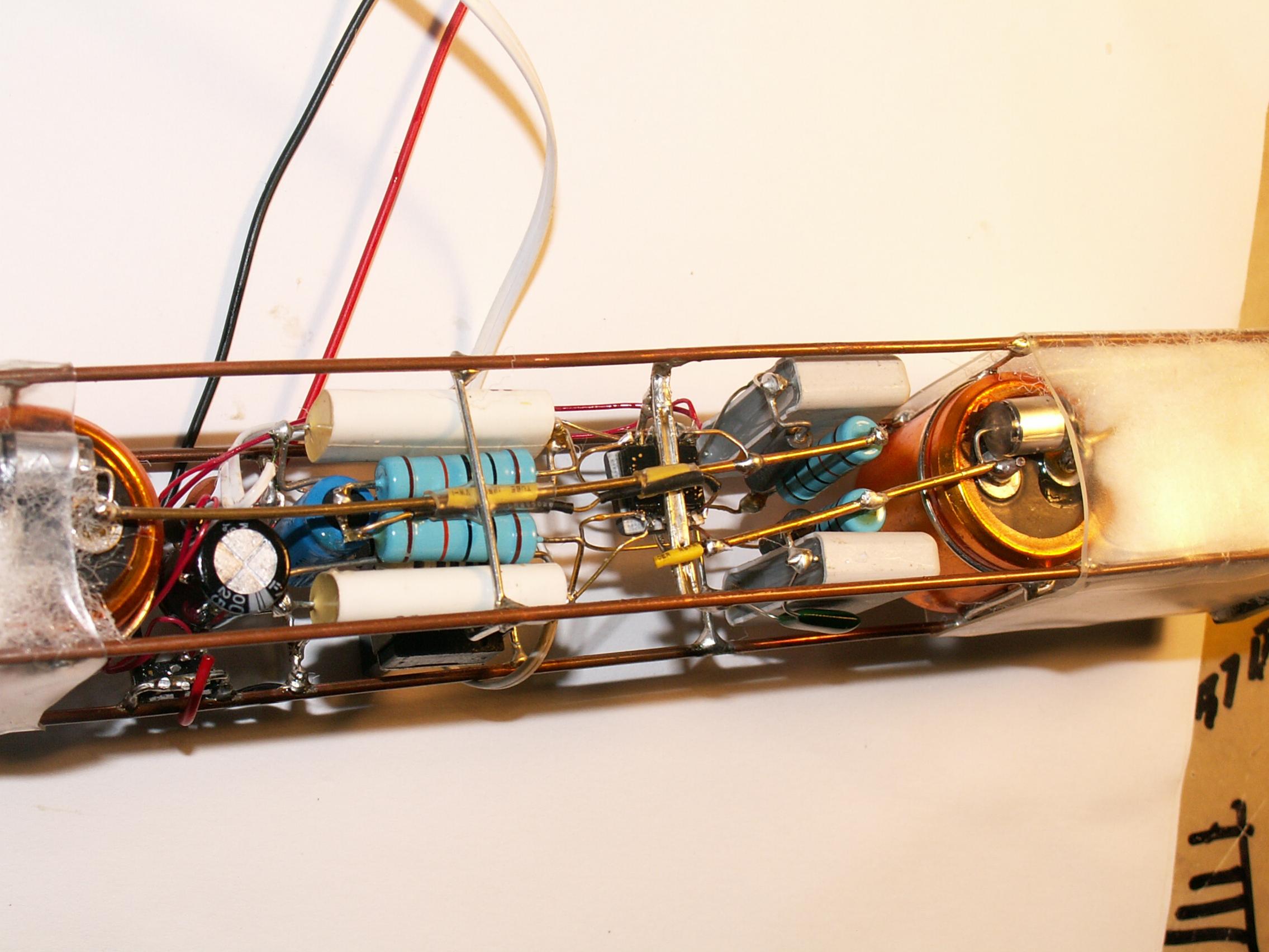

Very interesting. I had dismissed this chip based on the fearful rise in distortion with frequency shown in the data sheet. Intriguing that this is the very area you have highlighted as a strength. Love to know what's going on there!

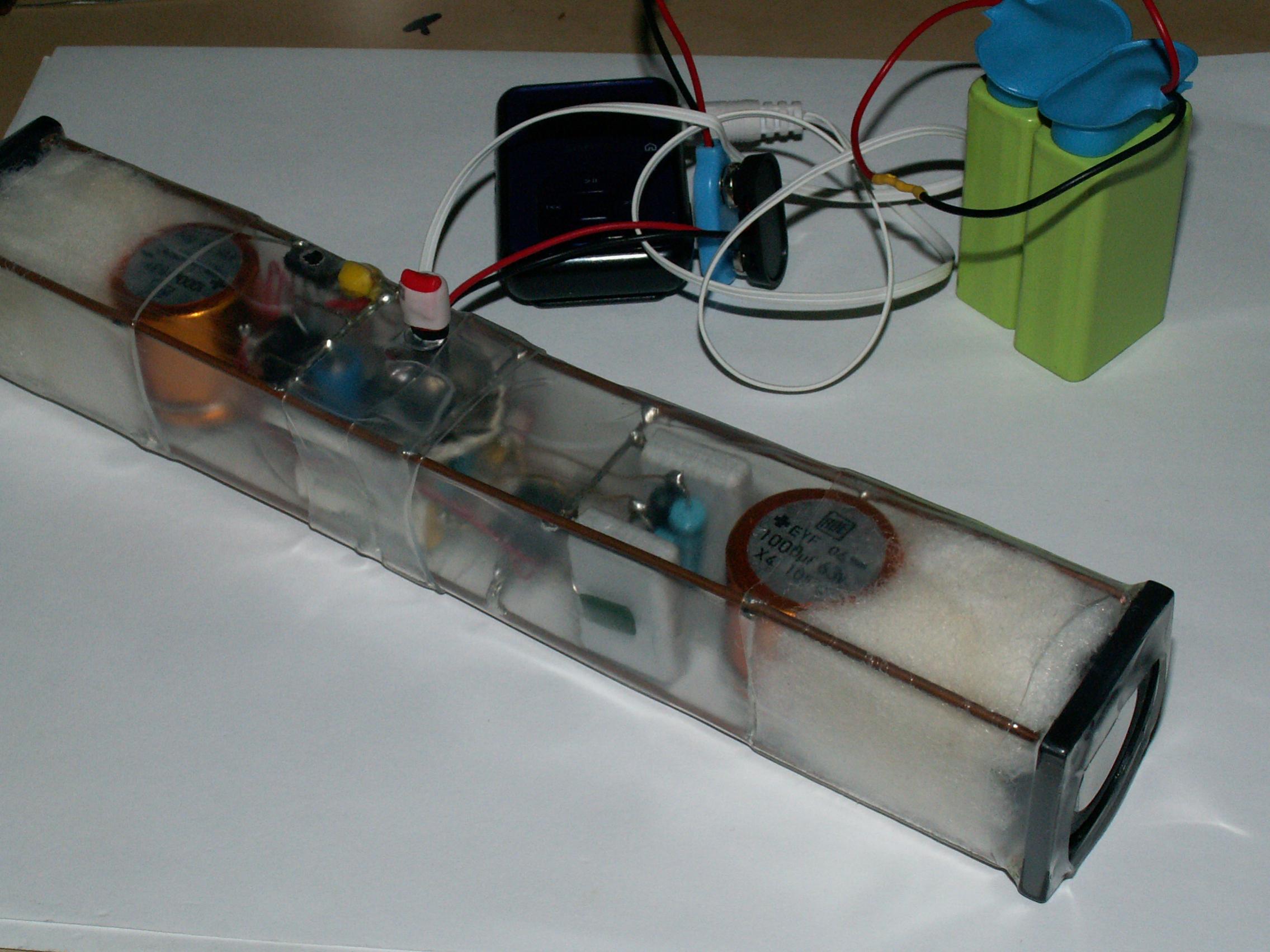

I added low noise polycarbonate in parallel with polyester film caps in distortion trap, pins 7 and 8, also wirewound resistors, low capacitance bypass caps for better treble response, no pcb must make for better component contact and conductivity, copper wire frame for decent grounding.
