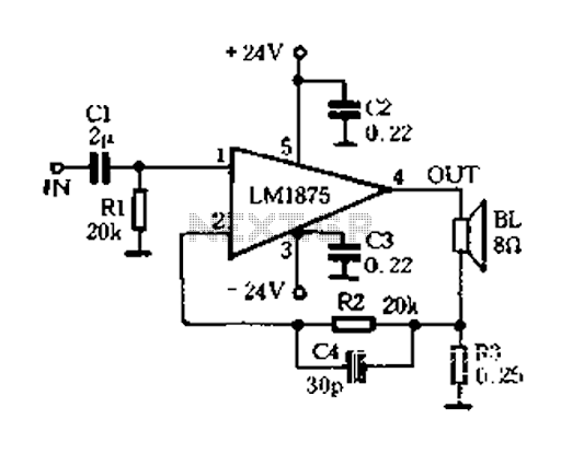

lm1875/tda2050 inverting mode
I can't find a diagram with the configuration similar to that of the datasheet, but in inverting mode.
Or if there are similar inverting and non-inverting equivalent schemes, so I can compare them as they sound differently.
can someone show me some links?

I built 3way active system with three stereo transconductane amps based on lm3886 chips. Powering normal speakers. Great sound. Even have my own way of wireing them. There is thread out there.
I do have about 10 stereo lm1875 amps, each different configuration. Standard based on application note, inverting with various buffers (mostly jfets), and many current source. Each type has its unique sound, even on the same speakers.
Saying that inverting and noninverting is the same is just wrong.
that would be pretty much impossible, but I can try
standard non-inverting is sterile, dry, but accurate
inverting with good buffer is better, more musical
current source is best, musical and engaging, seems even more dynamic
here is my theory, but I do not have data to prove it...
normal voltage amp is configured to amplify the signal, signal comes in, gets amplified, and negative feedback from the amps output is compared to the input to correct all the non-linearities, to have lowest distortion and flat response
voltage amp does this no matter what is connected to it, it does not even care if something is connected or not (just like sgrossklass)
in current amplifier, there is feedback reading what is actually on the speaker
this amplifier actually corrects signal to adopt to the speaker and its non-linearities
not only amps non-linearities
so in a sense it cares about what is connected to the amplifier
and that's how it should be
i believe it sounds better because transients are better, but as i said I do not have data to prove it
there is one italian web page which has some data on it, showing much better transients in current drive
We like to hear good music & that's the most important thing. You said it sounds better, subjectivly? we don't know & to know more about it we have to build one. But yes i understand your point. Although according to you it colours music through signal correction. The only current feedback amp i've ever built was tda2003 chipamp & as far as i can recall i liked that chip 🙂

No i didn't say that & kindly mention THD+N of your VFET amp at the level of 1watt. I was just trying to say that we shouldn't think too much about distortion & bla bla bla...... different isn't always better(subjectively). What we need is a good amplifier+ speaker combo which approximates signal level at a respectable level. Anyway voltage feedback is more popular & thats for a reason.
