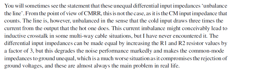

I would also match the input impedance for the balanced input.
For the negative side it's now 20k and for the positive input 6.67k.

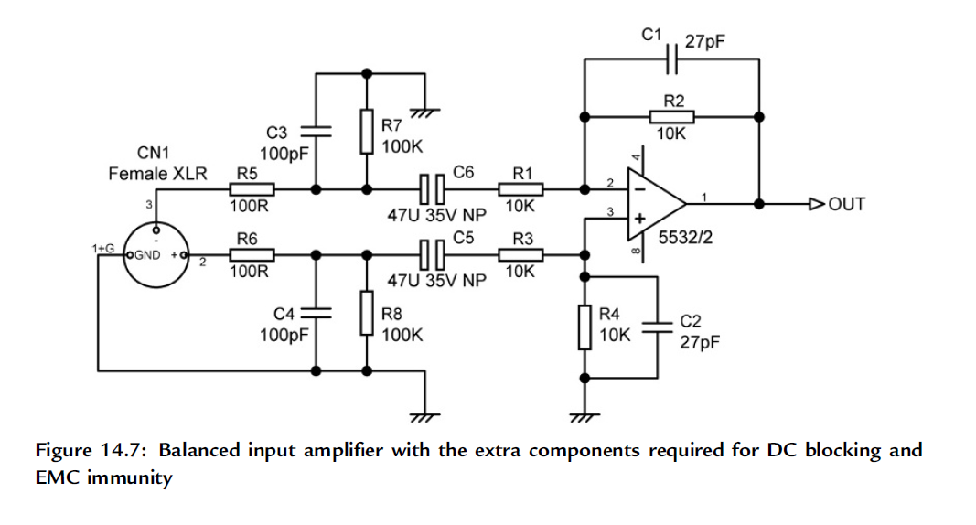

C6 and C17 seem a bit unnecessary
Also the values for C1 and C4 are a little high 4.7-10uF is big enough.
Depending on the use case I would even take them smaller.

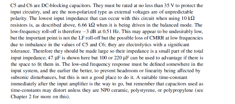

I put his quote about this in attachement.
C17 is there to prevent any DC offset to go into the power amp, and so to the speaker after it.
He said the bigger is the better here, so the capacitor doesn't mess with the common mode impedance, due to bad tolerance. He even advice to use 100uF or 220uF if possible. (Quote in attachement too)

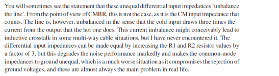

From Douglas Self, in "Small signal audio design", this should not be a real issue.I would also match the input impedance for the balanced input.
C6 is to prevent any DC offset difference between U1 and U3 to flow into the pot. Honestly I absolutly don't know if it is really necessary... I am gonna use NE5532.C6 and C17 seem a bit unnecessary
This is based (OK, shamelly copied 🙄 ) on Douglas Self design too (in attachement).Also the values for C1 and C4 are a little high 4.7-10uF is big enough.
