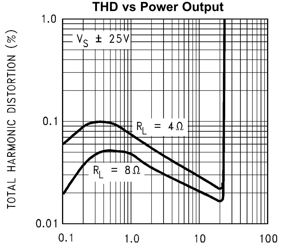

Udok's two attachments are quite revealing
At 20W of output one is showing 0.016% distortion.
The other is showing 0.0041% (11.8dB less distortion after NFB has been applied) and continues to fall to 0.003% @ 45W

one thing I find interesting that while distortion of LM3875 is actually increasing with decreasing signal/power...that is not pointing to "0/0" but shooting up, typical of AB class, distortion of LM1875 goes down, poining to much lower crossover distortion, similar to class A amplifiers...just an observation
the rise in the slope at lower frequencies is usually due to the higher proportion that noise contributes to the THD+N
It is rarely due to an increase in distortion.
Again when one compares the THD+N at 0.1W you see that the left is showing 0.02%, whereas the right is showing 0.016%
AndrewT, are you saying you can hear the difference in 0.020 vs. 0.016 % distortion?
If you personally prefer one chip to other, that's fine, but to state that...you know what, forget it.

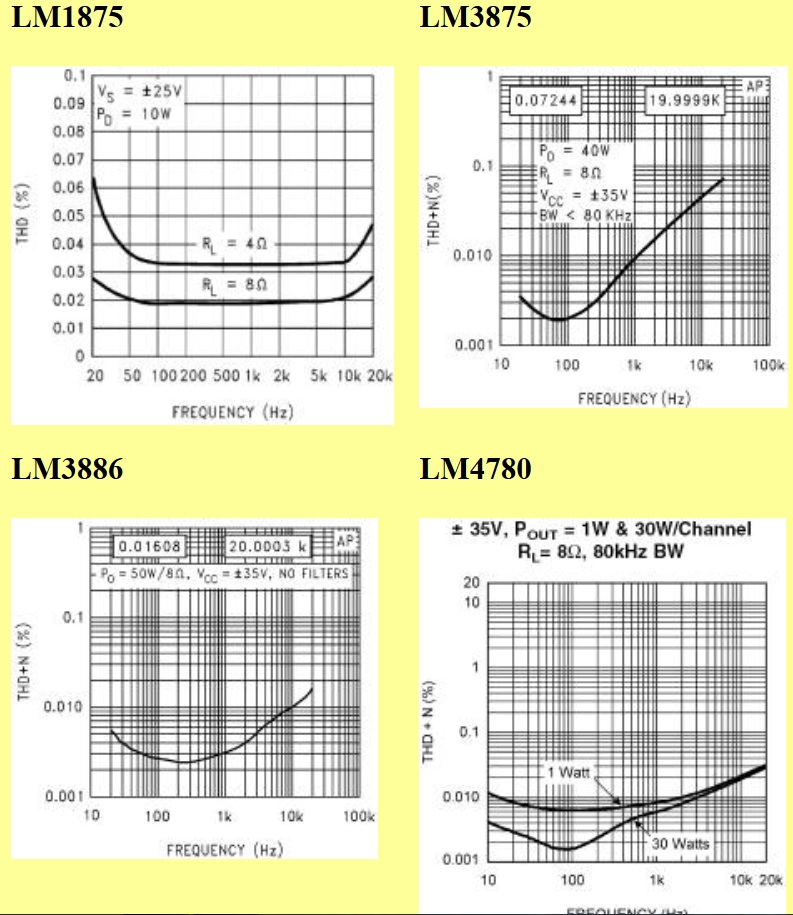

I put the distortion graphs from the datasheets in one picture so that the difference is clearly seen.
The LM1875 has no data below 0.1 Watt.
THD+N at 10 kHz is 0.04% @ 40Watt for LM3875 and 0.02% @10Watt for LM1875
Price for LM3875 is doubled in comparison to LM1875
