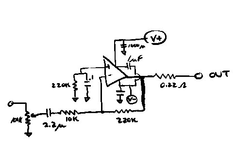

I use the inverting flavor
In the inverting version you don't have to worry about an electrolytic (C5) in the ground return path. In the non-inverting example which you show, this cap should be bypassed anyway with a mylar (although you won't see it in the Nat Semi site).
You can be a little clever if you burn some printed ciruit boards for this by placing R2 and R3 on the bottom of the board. A 1/4 watt resistor will fit perfectly. This keeps the leads very short. I also cut off the "NC" leads since they just get in the way.
note that the pins for this chip are on 0.067" centers. I created a component in Ultiboard for this and one of Nat Semi's motor control chips (LMD18200/18201) which uses the same layout.
I found that the distortion with these chips was actually a little better than Nat Semi claimed. They state 0.06%, 20Hz-20kHz, I found 0.04% (at least in the inverted version).
Here's a rough schematic
The 1.0 uf capacitor bridges the V+ and V-. This particular design is for the '3875 which lacks the mute feature. I have used 330uF caps and 1000uF caps and can detect no difference.

The added components add nothing to the noise
the inductor in the Nat Semi (non-inverted) design is about 7 turns of wire on a 2 watt resistor, and the 0.22R resistor in the Thorsten (inverted) design won't contribute any meaningful noise either (I use a pair of 0.47R's as a I have hundreds of these bought for a buck). At any rate, a pic is enclosed showing the resistors attached to the bottom of the board.
