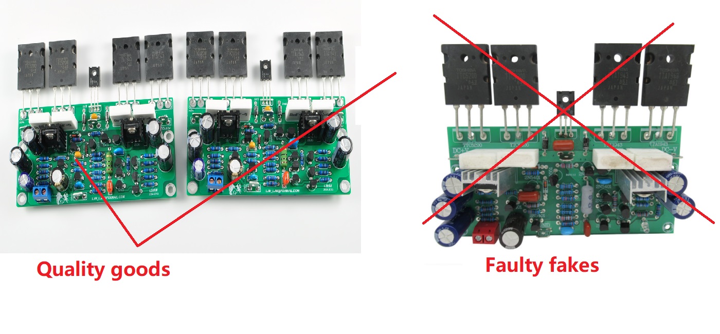

It can be used without a pre amplifier.
The 10K potentiometer is very good. Just use it directly.
I rarely use the preamplifier.
Pay attention to the power supply and heat dissipation. These two are very important.
In addition, you need to pay attention to the real goods. And fake goods.
In case of fakes. Please email me ljm_ljm@foxmail.com[/email]

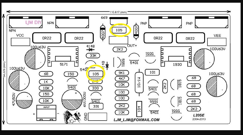

Can someone please suggest correct value of capacitor in marked areas?
Boards I have received show "106" ie 10uf while pictures from other sellers show it to be "105" ie 1uf.
So should it be 1uf or 10uf ?
Thanks in advance.
Thanks in advance.
From the early days, I used 105.1uf
Later I thought 106 might be better. So I changed it to 106.
Later in use, I found out. There's no difference. ok
In order to avoid doubt from customers. Because the word printed on PCB is 106. Then I have to mail 10 UF BP capacitor to customers. In fact, there is no difference in use.
