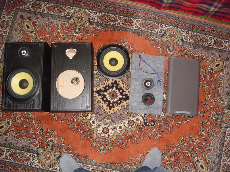

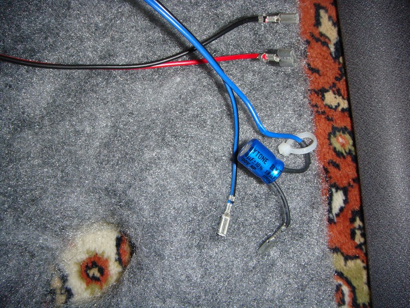

When i removed the drivers, i was disappointed with the wiring and crossover network, both of the driver cables were 0,5mm² ordinary copper wires connected with standard connection sockets inside and a "elytone" brand (probably china made) 1,8uf non-polar electrolylitic capacitor. On the other hand, thickness of walls and general workmanship is better than many more expensive cabinets around.

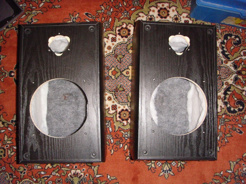

First of all i removed what's inside the cabinets, drivers, socket and the synthetic wool. There was only one piece of wool inside, placed on tha backside, but not attached to anywhere. I decided to cover all the walls with wool and attach them so they could not cause any nasty problems. With ordinary wood glue, i placed the old piece wool on its original location and covered all the other walls with a thinner fibre wool because i didn't want to reduce the volume of the boxes. After glueing, i let them dry for about 3 hours.

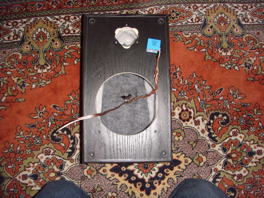

After the internal wool covering, i've been detailing on the wiring. The midbass cable i used is 1,5mm² oxygen free copper and 0,75mm² for the high frequency driver, again ofc.
The high-pass capacitor was a cheap electrolytic as i mentioned above. I used an EVOX PMR series (metallized polypropylene) capacitor in that position and increased the value from 1,8uF to 2,7 uF because i wanted a better high-mid frequency response. because the evox cap is bigger and heavier than the elytone, i glued it inside the box and on the front wall of the cabinet.
Instead of ordinary sockets that sony used, i soldered the wires to the terminals with a remarkable amount of solder for the best conductivity. After finishing the connections, i insulated all of them with electrical tape, twisted and fixed them together with plastic handcuffs. To reduce the resonance transition between the box and the surface beneath, i put tiny rubber pads under the cabinets.
