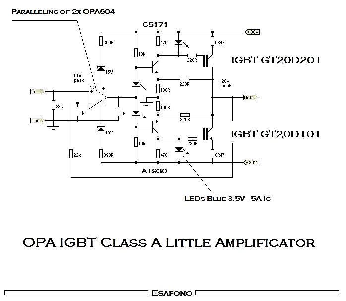

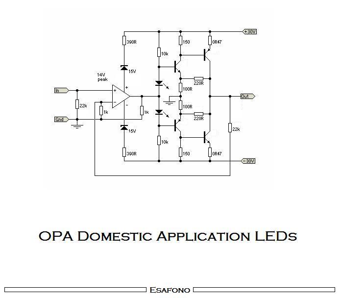

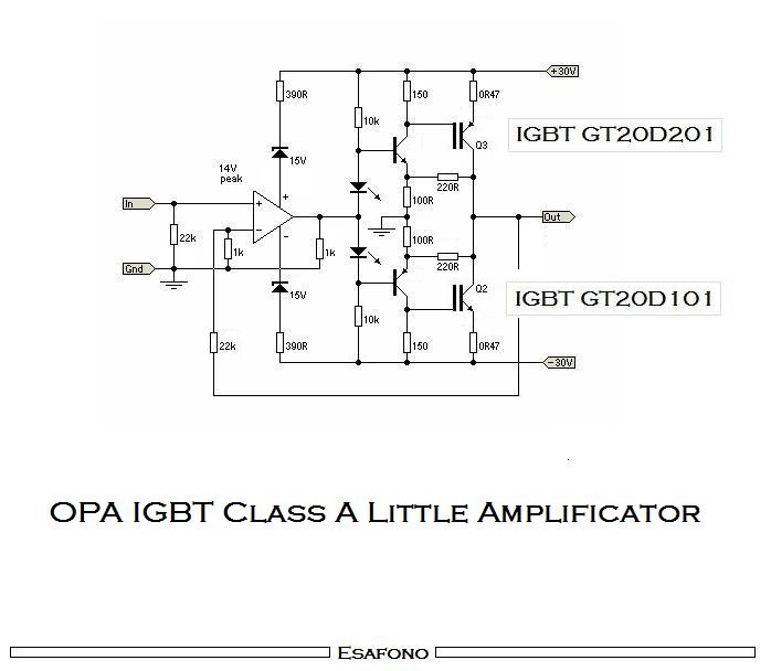

Little Class A ?
USE an OPA !
see this circuit
from cut and paste of an italian KIT
never tested
better have to connect twice CAR loudspeakers
because power is little
oh man, that looks old, are thoose really silicon transistors? hmm well I guess it's possible.

that is good to have an accurate VAS
with a domestic power
need just design a current stage in class A
easy with LED's polarization
you have to select numbers and color!
...the problem is thermal drift control
maybe a very big dissipator it's a way

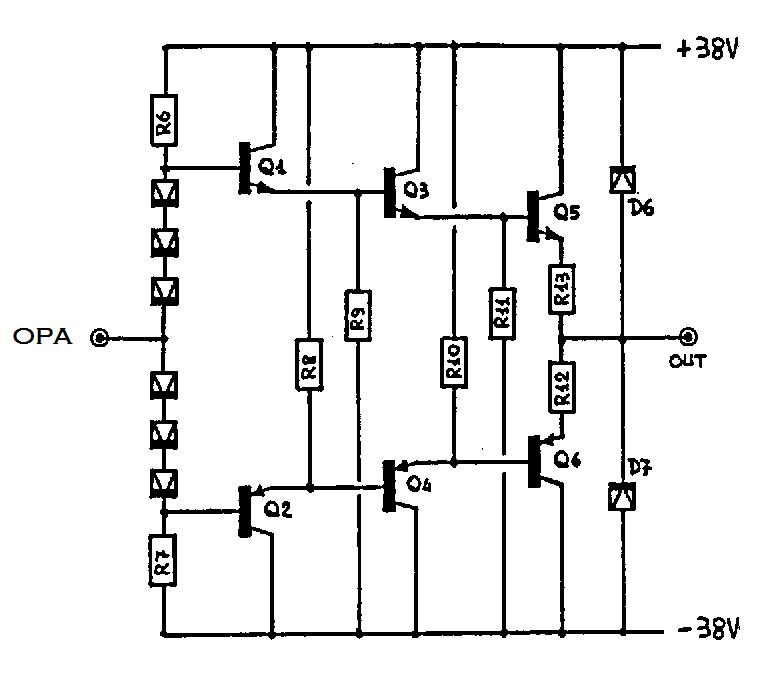

or see this current stage with IGBT
http://www.diyaudio.com/forums/showthread.php?s=&threadid=128784
